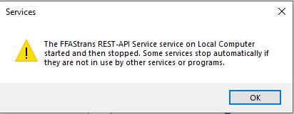

I am trying to configure a Farm with two machines. Version of FFASTRANS is 1.3.1. Not sure if that is the issue and I need to use a newer version.
1st machine has the application running as a service. I made the folder where the FFAStrans.exe file is located, shared on the network. I would open the FFAStrans.exe file on the 2nd machine, but it fails to start the the FFAStrans service. The same user is used on both machines and is admin user.
Attached is a screenshot of the error message when trying to start the service on the 2nd machine.

Did you open the executable from the same network path?
I always suggest running from the actual UNC path like \\whatever\FFAStrans.exe
Anyway, once you opened the Workflow Manager, can you check what it says at the bottom?
If it says "Running as application" then it means that it's actually running from the .exe itself.
When that happens, you can't start the rest_service because it's already running as an application, so you have to go to the options and untick the "run as application" and then you're gonna be able to start the rest_service.

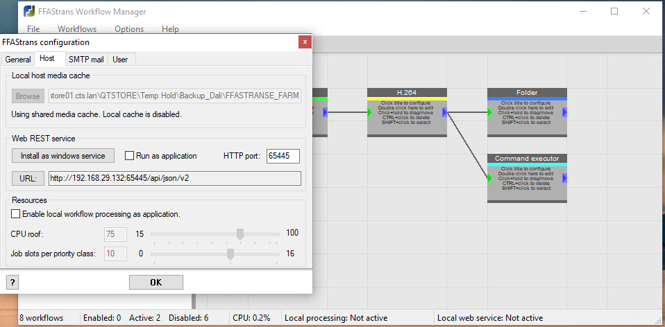

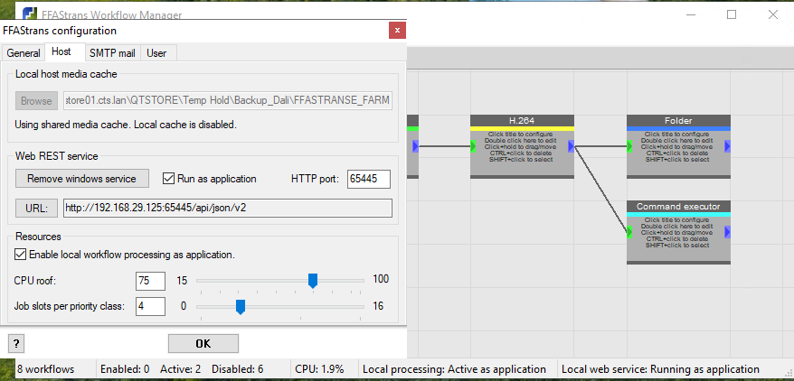

I followed your instructions and see the following:
Server 1 (Master): Local processing: Active as application | Local web service: Running as application
Server 2: Local processing: Not active | Local web service: Not active
I've attached the screenshots for you to review and confirm that this is the correct setting.
Also, on Server 2, I ran the rest_service from the shared folder on Server 1. Is that the correct method here?
- Server2Config.PNG (84.65 KiB) Viewed 90687 times
- Server1Config.PNG (49.6 KiB) Viewed 90687 times
