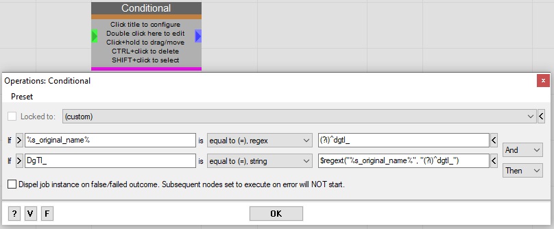

For reference I use https://regex101.com/ with PCRE2 (PHP >=7.3) when I test my regexes. So this is a good start so you know your regex is corret. And as @emcodem points out, you don't need the regext start/stop slashes. However, you do need to set if you want case insensitive in the regex function. So your correct function would be: $regext("%s_original_name%","(?i)^dgtl_"). However, this function will extract the string as opposed to testing if it matches.
To test, just add a single conditional node and submit the source to it. Take a look at the two tests below. They do the exact same thing but with two different approaces. You CAN use both just for the heck of it but I think the first one match your usecase best.
Hope this helps :-)

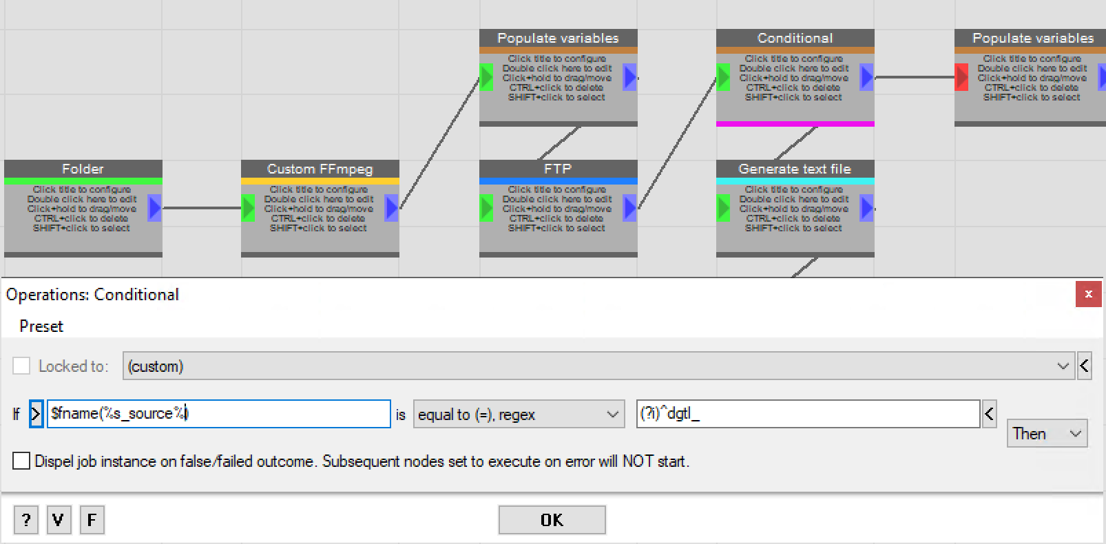

For now a have only one question - how to findout filename of s_source from previous node.
$fname(%s_source%) don't work as expected, or again - i do something wrong.
1st regex match of "$fname(%s_source%) = (?i)^dgtl_" is "$fname(\\ffast1\ffas_jobs\test_j\dgtl_1702.mxf) = (?i)^dgtl_"
2025-02-25_Remote Desktop Manager-005706.png (65.99 KiB) Viewed 53659 times
Re: CONDITIONAL QUESTION
wrong:
$fname(%s_source%)
correct:
$fname("%s_source%")
