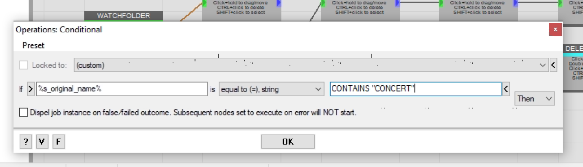

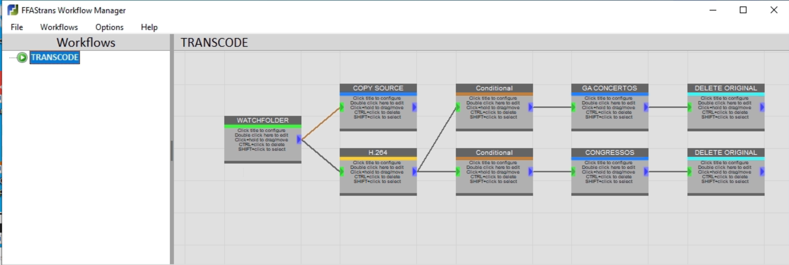

Hi To All
I'm new here. Amazing Software that you built ...congrats.
I record a lot of *.mov files
2024-11-04_CONCERT.mov
2024-11-06_CONGRESS.mov
I'm trying to build a MP4 transcoding workflow, where after transcoding, it should move the *.mp4 file to CONCERT or CONGRESS folders. I'm trying to work this movement with the file name but without success.
attached are some printscreens

Re: CONDITIONAL QUESTION
Hey Jh, welcome to the forum and thank you for using FFAStrans!
In the Screenshot you sent bottom left you see a little ? symbol, it opens an explainative help (just in case you didnt find that yet).
There are multiple ways to get what you want, the most straight forward might be:
%s_original_name% = *CONCERT*
Your current check only works if the source name literally contains the phrase: CONTAINS "CONCERT". The conditional processor does not support "written" comparison control statements like CONTAINS. The only way to choose how the comparison is done is the middle dropdown that contains the different comparison controls we have (=, regex etc..)
Once everything works as expected, you can check the "Dispel" checkbox at the bottom, this will delete failed decision jobs.
On a sidenote, the way you do it is most natural and beginner friendly, a solid solution. Of course there are advanced ways to do this, which allow to work without a "split" and a copy of all the processors just for the purpose of dealing with 2 different target locations. You could work with user_variables and regex in order to get this done. But there is no need to play with this advanced concepts if your workflow stays as simple as it seems to be currently.

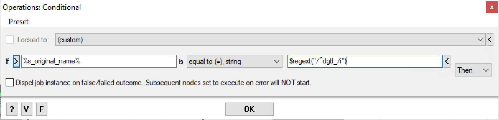

Hi @emcodem.
I really try to make right conditional by myself, but it's don't work as i expected.
I need to check file name after delivering node, If the filename contains prefix "DGTL_" do POST.
I understand that best will be make it throw $regext("/^dgtl_/i"), but a can't make correct sequence => Deliveries -> Conditional.
2025-02-24_Remote Desktop Manager-005656.png (31.03 KiB) Viewed 50029 times

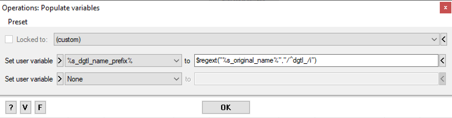

I also try to make it throw populate var => Deliveries -> Populate Variables -> Conditional.
2025-02-24_Remote Desktop Manager-005658.png (25.25 KiB) Viewed 50029 times
For now i don't understand correct expression and sequence for if-then-compare :(
@artjuice
There is a manual for the functions in the populate processor at bottom, Bold F symbol.
For executing a regex, we need at least 2 things: the input (e.g. filename) and the regex pattern.
Working example:
$regext("%s_source%","a")
This checks if there is a small "a" in the source file path or name. If you store this to a variable, the variable can be either "a" (if yes) or nothing (if no).
Also, i believe we dont support // and flags in regex but we do incasesensitive anyway. So your regex could work as
$regext("%s_original_name%","^dgtl")
Copy of Manual for $regext function:

@emcodem
No, don't work, im do something wrong, but don't understand what.
I make easy WF = Monitors Folder -> Conditional (%s_source% equal to $regext("%s_original_name%","^dgtl_")) -> Create text file (where must be only filenames with "DGTL_" prefix).
But have an error: "1st evaluation of \"%s_source% = $regext(\"%s_original_name%\",\"^dgtl_\")\" is \"\\\\ffast1\\ffas_jobs\\test_j\\DGTL_tets2.mxf = \""
I also try to change %s_source% to %s_original_name%
And also make it throw Populate variables, where i map %s_dgtl_prefix% to $regext("%s_original_name%","^dgtl_"), and than use it in Conditional
1st evaluation of \"%s_original_name% = $regext(\"%s_original_name%\",\"^dgtl_\")\" is \"DGTL_tets2 = \""
To be fair, if you want the conditional to return "true" for all files starting with "DGTL_", then there's no need to mess with Regext, you can simply do:
if %s_original_name% == DGTL_*
and it's gonna work with a simple conditional. ;)
