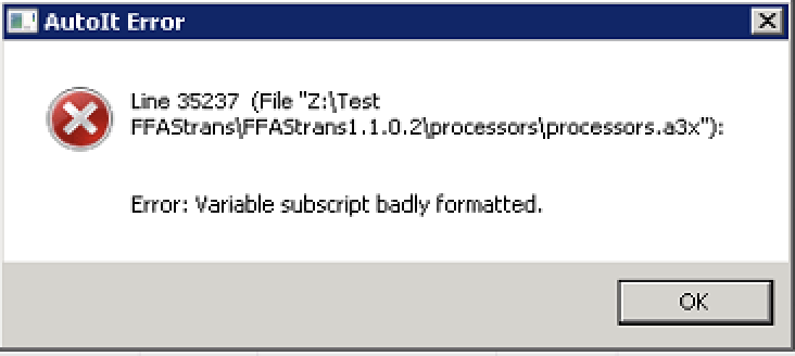

There is also another problem. Since the workflow is running and checks file after file i encountered an error on some servers were FFAStrans runs. See screenshot.

- error.png (29.78 KiB) Viewed 8667 times

if @admin doesnt reply to that, i'll check in the next days what this means or where it comes from.michael85 wrote: Wed Jan 20, 2021 3:06 pm There is also another problem. Since the workflow is running and checks file after file i encountered an error on some servers were FFAStrans runs. See screenshot.

The error occurs on 2 of 3 servers. Regardless if a job is running or not.
Maybe it is helpful for the admin to see the mentioned file in the error message. I have attached them.

Hi michael85,
The bug you're seeing is due to some information missing that aught to be there. It might be a corrupt workflow but it might also be one of the many issues we have resolved for the upcoming 1.2 release. It's a bit hard to say without having the workflow that initiates the issue. If you know what workflow it is maybe you can send it and I'll take a look and see if it could be some sort of corruption.

The error comes up really often and I have the feeling that the servers wont encode anymore until this error message is closed by clicking on "ok".

I'm not able to get your workflow to fail even on the 1.1.0.2 version...But there has been several changes to the code surrounding the issues because I have seen it before so it was addressed. So, for this I think we just need to see how 1.2 behaves. It's scheduled to medio February.
