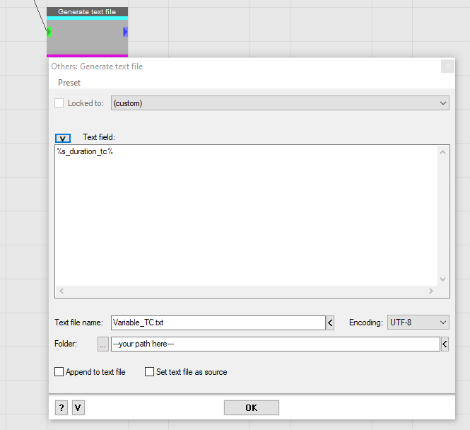

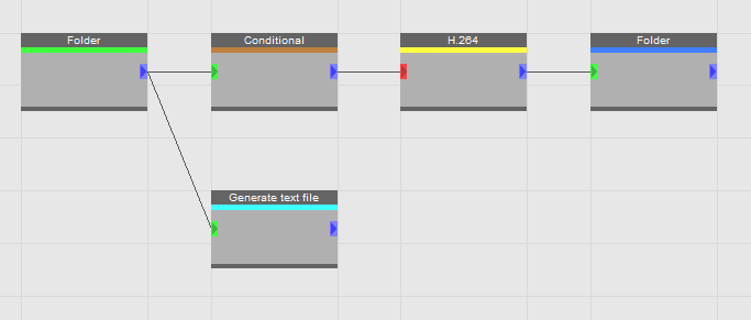

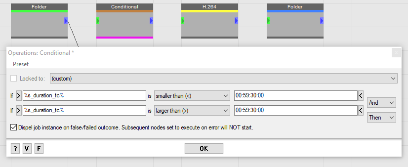

Hello Michael and welcome here.
I think you have to do a test first to check a file with a 59:30:00 duration has really the exact duration otherwise all your files will process.
Maybe you can look at the picture I did and create a generated text file to be sure of your duration_tc variable.(picture 1)
Just enter a path to the txt file and submit a file. You will be able to see if the duration is exactly 00:59:30:00.(picture2)
You can also have another point of view for your workflow. Instead of use a "=", you can use a < and a >. If you do taht, make sure you right click on H264 input connector and choose green.
So if the file found is smaller or larger than 59:30:00 it will be encoded to h264, otherwise no. (to avoid a lot of message in the status monitor, check the dispel job instance).(picture 3)
Hope it helps.
Hope it helps.

Hello everyone and thank you for your outstanding help.
I have checked the Duration of my files in FFAStrans as described from you. And the result is really weird, which leads me to another problem.
FFAStrans detected a Duration of my (to be separated files) between 01:00:43:02 and 01:00:43:09 instead of 00:59:30:00. I have tested several files.
This happens only to files which were created by file ingest from my Video Server. All the other files (same format and codec), who comes from the post production (Adobe Premiere) has the same TC in FFAStrans as they were exported from Premiere.
I'am definitely sure, that my files from the Video Server has a proper Duration of 00:59:30:00. MediaInfo says the same to this Files. I have attached a report from MediaInfo of one of these Files.
Anyway, I tried the solution from momocampo (picture 3) and set the Conditional Node to:
IF %s_duration_tc% is smaller than (<) 01:00:43:00 AND
IF %s_duration_tc% is larger than (>) 01:00:43:10 THEN
H.264 Node = Execute on success
This ends in the result, that FFAStrans denys all files that I have tested:
File1 had of Duration of 00:02:08:08 --> Result: "1st evuluation of "%s_duration_tc%<01:00:43:00" is "00:02:08:08<01:00:43:00"
File2 had of Duration of 01:11:26:02 --> Result: "1st evuluation of "%s_duration_tc%<01:00:43:00" is "01:11:26:02<01:00:43:00"
File3 had of Duration of 01:00:43:03 --> Result: "1st evuluation of "%s_duration_tc%<01:00:43:00" is "01:00:43:03<01:00:43:00"
I dont understand why these 3 Files didn't met the condition No.1. because File 2 and File 3 are not smaller than 01:00:43:00.
I also do not understand why the Duration from my ingested files is far away from their real Duration. Is this a bug in FFAStrans or is there a problem with files from the video server?
Best regards
Michael
Best regards
Michael

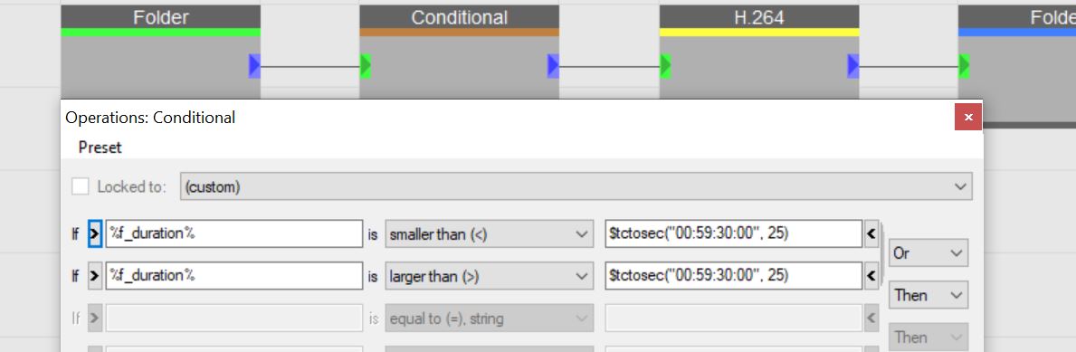

Re: Monitors:Folder deny files by using variables
Hi michael85,
I'm sorry but you can't compare TC like that. Essentially the conditional is based on comparing text and numbers, not special stuff like TC or other complex string notations. However, the solution is quite simple:
IF %f_duration% is smaller than (<) $tctosec("01:00:43:00") AND
IF %f_duration% is larger than (>) $tctosec("01:00:43:10") THEN
So you see you need use the duration in seconds (%f_duration%) and compare it to the $tctosec() function with the desired TC duration applied.
Hope this helps.
Hope this helps.
Hi all,
Oups, my mistake and I am so sorry. It doesn't make sense to compare tc values like that , true.
And more it is not "and" into the conditional but "or" (media can't be smaller AND larger !)....I realy need to rest
Anyway, look at the capture, it should be ok this time.
Sorry Boss, hope I won't be punished...
- cond.JPG (54.85 KiB) Viewed 14907 times
