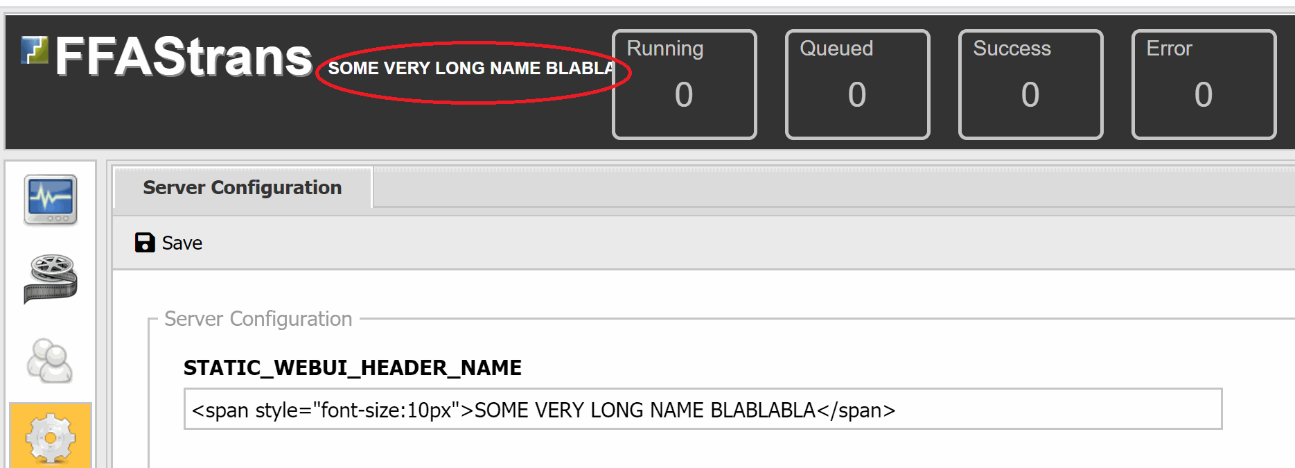

Small tipp, you could actually expose the webint directly to the internet (enable auth) and just open the ports between the machine where webint runs on and ffastrans.
Also, i see you have troubles with the space for "instance name". Documentation on that will follow shortly, but you can use html in the instance name field on admin panel, like that:
<span style="font-size:10px">SOME VERY LONG NAME BLABLABLA</span>

Hey @emcodem
I'll definitely use that, for the instance name. As for exposing it to the internet, I would have loved to have done that, but my workplace is really strict on opening ports and devices to the outside, requiring a bunch of paperwork and such. So the website setup was the easier option.
