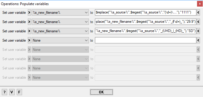

Take a Populate Variables processor, create a new User variable to hold the calculated target filename (in my example "new_filename") and do your regext like that:
$replace("%s_source%",$regext("%s_source%","(\d+)\...."),"1111")
$replace("%s_new_filename%",$regext("%s_source%","_(f\d+)_"),"29.9")
$replace("%s_new_filename%",$regext("%s_source%","_(UHD)_|_(HD)_|_(SD)_"),"SD")
The first regex with the "1111" at the end will take any number before a dot followed by three characters (i hope your extensions always have 3 characters)
The last part, "1111", "29.9" and "SD" sure needs to be replaced by some other text/variable from you, it represents the stuff that is inserted into the new filename.
