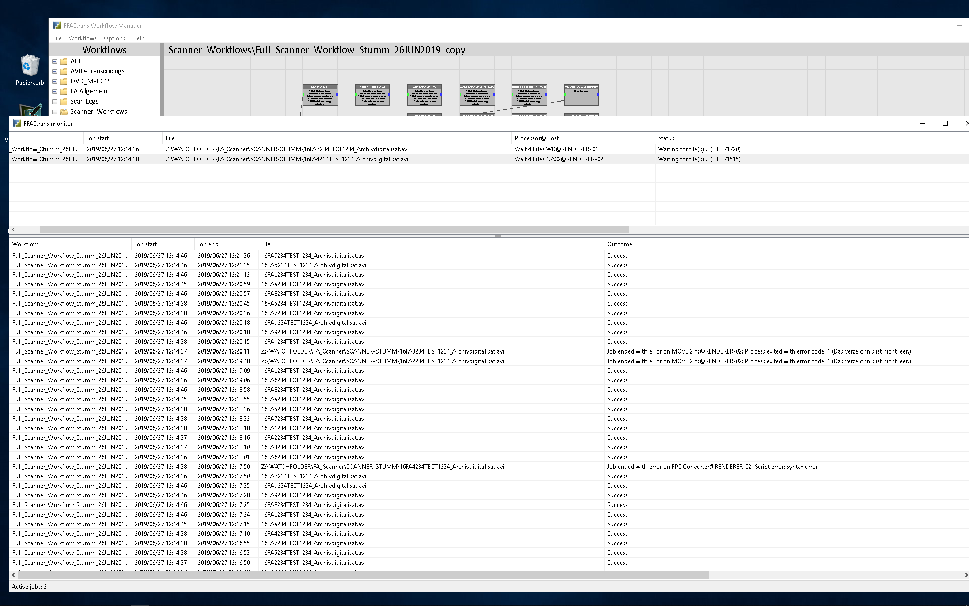

I´m afraid it is not an spoiled AVIsynth-script, but is a problem by picking up files and / or distribution of tasks between our two render-stations. I attach screenshots from three encode-sessions with the workflow from the last posting. Here it is clearly to see that not only AVIsynth-scripts but also other nodes on both renderer give an error. The three encodings had all the same files. As you can see, the errors occur on different stages in each run. The Pickup-nodes and deliver-directorys were resetted, history-cleared and all encoded files deleted before each run.
I thought, maybe it is because of intenive branching. So I took some other files an a One-Branch-Workflow (attached).
But I was not succesful. See the next screenshot for some strange behaviour, that the Workflow discards some files as if they had no video (they definetily have...) and try to pick up successful transcodings again.
I attach all the files as a .ZIP because my browser or intranet seems to kill the screenshots after uploading to this forum... Sorry for this inconvenience.
thank you for your support

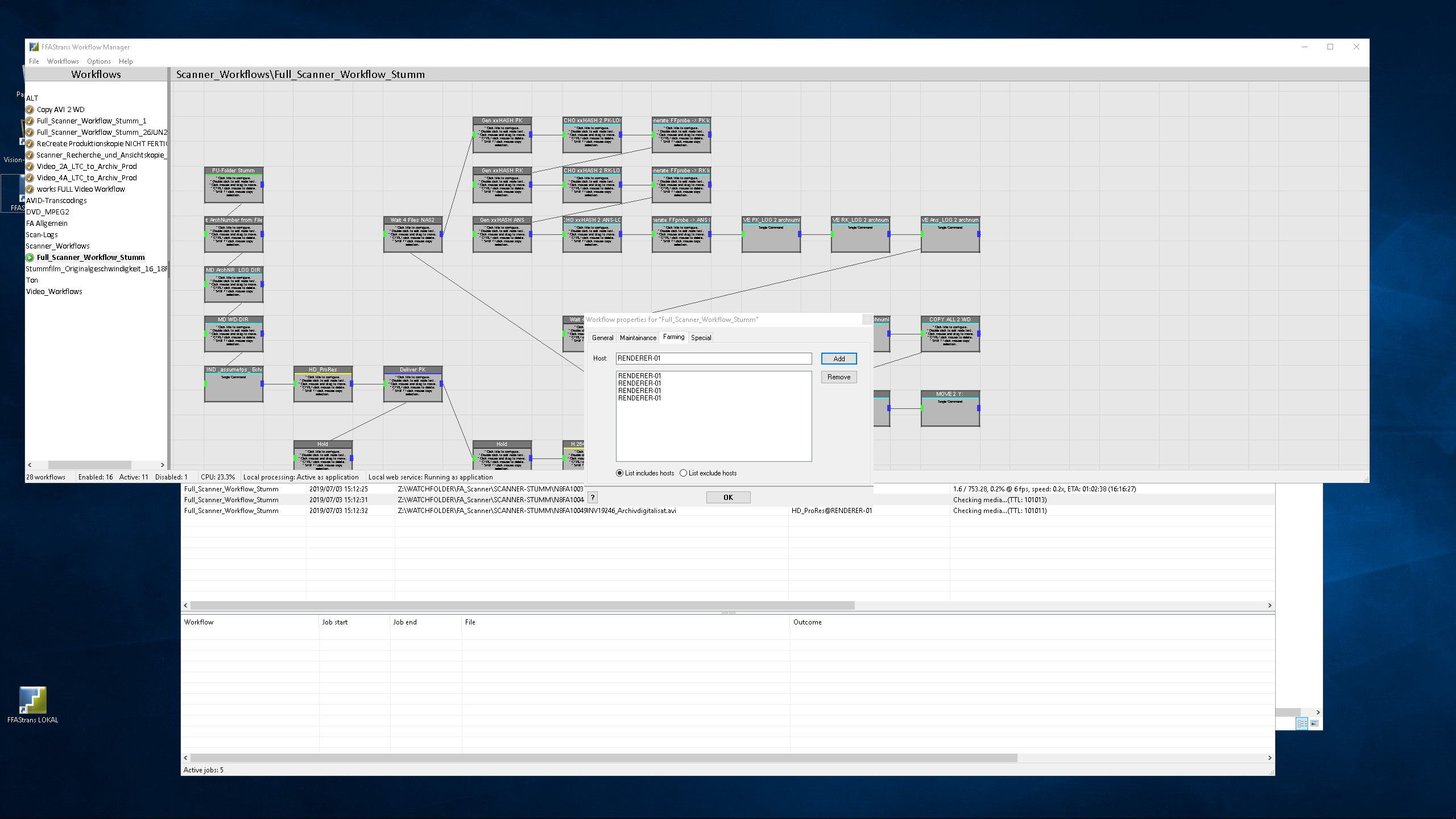

When looking at the Workflow-properties, I can not see the workstations in Farming-Tab. I see only the machine on which I am actually working on. Also I can choose thgis workstation a multiple time - normal behaviour?
regards,
tom

Re: How to setup farm correctly? Errors when farming
Hey Thomas!
i don't think there is a Problem with "file is not being written completely" or synology or so, your Settings of the monitor node "check once for growing" is good. Maybe you also want to check "Forget missing" in order to be able to process the same filename after it left the watchfolder once.
I checked all nodes in your workflow (and workflow Settings) for paths and found out that you currently use These paths:
Z:\WATCHFOLDER\FA_Scanner\SCANNER-STUMM
Y:\WaitingDirectory\%s_archnumber%
S:\NICHT LOESCHEN FFAStrans\
Z:\FFAStrans_Logs\
All These paths must be exactly the same on all Systems and ffastrans must be started on all nodes from S:\NICHT LOESCHEN FFAStrans\
Also, make sure to check the "use global shared media Cache" stuff in Configuration->Host and in Configuraiton->General set it to a Shared Directory like S:\.ffastrans_work_root
In General, make sure that no file at all ever goes to a local drive like C:\, especially not temporary files like encoded files or avs files in Cache Directory.
Can you confirm that?
Also, Your screenshot about the Farming tab Looks strange, it should only look that way in case you added renderer01 multiple times to the list.
Looks like there is something strange to your farm, make sure on both machines you start ffastrans from exactly the same path (S:)...
For your log.txt, it would be good if we also had the processing logs for it because one would see the path/filename that was not found on RENDERER-02
All your Errors seem to come from RENDERER-02, i assume one of the mapped Network drives is not the same than on the other machine.
