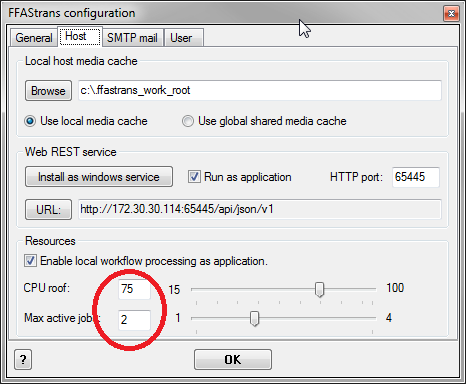

The only Thing that currently Comes to my mind is that you can Play witht he CPU Roof and max active Settings, try 100% and at least 2 for max active... in options->configuration->host
