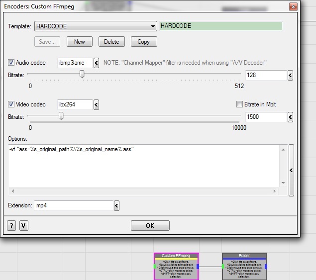

Good morning guys,
i'm crreating a batch for subtitles burn in...
but it gives me always an error...
i have done a custom ffmpeg with the classic ass string inside....
i have tested with both SRT and ASS syntax... but nothing!
Can you help me?
Can you help me?

Re: BURN IN SUBS
are the quotes set correctly? Shouldn´t it be -vf ass="{path}" ?
cheers,
tom
cheers,
tom
Re: BURN IN SUBS
Hey there,
you always need to be aware about how the strings you build from variables looks like when it is executed.
E.g. you provide this:
When this is executed for an input path like this: \\server\share\folder with spaces\file.ext, it looks like this:
Now, if you try this on commandline without ffastrans, you will most likely recognize that ffmpeg is not able to find the ass file, or even throw an error message About a filter named "with" and "spaces…" not found. You might need to escape your path properly, e.g. ":" needs to render as "\:", "\" as "\\" etc...
A workfing example might most likely look more like this (not 100% sure About that):
or even this:
You can read about escaping in filters here: https://ffmpeg.org/ffmpeg-filters.html# ... h-escaping
To get further help, please try it on commandline and post a working example with the actual full path to your .ass file there and we can try to get out how you can dynamically properly escape your path using ffastrans automation.
cheers,
-vf "ass=%s_original_path%\%s_original_name%.ass"Code: Select all
-vf "ass=\\server\share\folder with spaces\file.ass"A workfing example might most likely look more like this (not 100% sure About that):
-vf "ass='\\\\Server\\share\\folder with spaces\\file.ass'"Code: Select all
-vf "ass='\\\\\\\\Server\\\\share\\\\folder with spaces\\\\file.ass'"To get further help, please try it on commandline and post a working example with the actual full path to your .ass file there and we can try to get out how you can dynamically properly escape your path using ffastrans automation.
cheers,

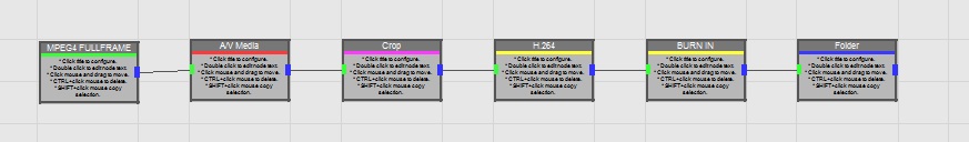

Re: BURN IN SUBS
Ok Guys, i solved the probblem with the escaping... the functioning script is this
-vf "subtitles='s\:\\subs\\%s_original_name%.srt':force_style='fontsize=30, outlinecolour=&h80000000'"
inside a custom ffmpeg node.
I put an SRT file, with the same name of the file to burn in, in a folder called "subs" on the S drive... it works perfectly
but if i apply other nodes, or i insert the same code under the x264 node it doesn't works.
For me could be important to position subtitles over the image and not on the letterboxing black bars and it could be useful to crop the image.
the only way to encode is to put an intermediate encoding node before the one with the subtitle burn in code... in this way it works but it takes twice time... a sort of two-pass.
What i'm doing wrong?!
thank you so much
L
thank you so much
L

Re: BURN IN SUBS
Good monday
unfortunately there is no known to me way to apply a ffmpeg filter (like subtitles) to any other node than the commandline or custom ffmpeg node. E.g. the "H.264" processor provides an option for custom "x264" encoder options but no way to provide "-vf" filtering options.
Again my recommendation is to go with the custom ffmpeg processor or commandline.
cheers!
cheers!

Re: BURN IN SUBS
Currently FFAStrans has no way of forwarding custom ffmpeg filter options to the inbuilt predefined encoders but I'm looking at a way to implement it. The problem is that the filter part in ffmpeg is used extensively to do color, framerate, interlacing, aspect and geometric conversions. So adding a custom -vf must fit into the existing filter chain while perserving the existing conversion logic.

Re: BURN IN SUBS
the crop is a "workaround" to burn subs in the correct position when the source is letterboxed. This is the way i use handbrake.
But using ffmpeg (and also handbrake) i cannot add a sort of vposition of the subs, and inside ffastrans, if i add avisynth nodes before the one with custom ffmpeg it gives me an error. Using the script i have showed it works but ovviously it performs a sort of double pass encoding and i loose all the advantages!
I cannot find any command... to subtitles filter or ass filter to resize the subs before burning in!
mmmm
L
mmmm
L
