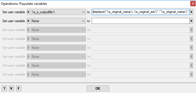

In a populate variables processor, create a string variable named something like "s_outputfile" and set the value to this:
$replace("%s_original_name%.%s_original_ext%","%s_original_name%", $triml($trimr("%s_original_name%",31),8),0)

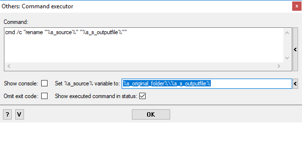

Anyway, after importing your workflow, i see that in your "Populate variables" node, you created a variable named %s_s_outputfile%, but in your "Command Executor" Node, you are using the variable %s_outputfile%, which does not exist. Furthermore, i don't see that you use my first code line (the complex one), you should copy and paste it into the right side like that:
And as your variable for "outputfilename" is "s_s_outputfile", you have to set this variable in the command executor node like that:
cmd /c "rename "%s_source%" "%s_s_outputfile%""
Then, i see that you don't set the new s_source variable in the command executor, which would disable the "Folder" node to copy the new File, so in your command executor node, on bottom left, set the new s_source variable to "%s_original_folder%\%s_s_outputfile%" like that:

My bad, the line for the Command Executor, bottom right in the textbox for "Set %s_source% variable to:" should more be like that:
%s_original_drive%%s_original_folder%\%s_s_outputfile%
