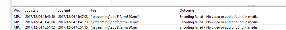

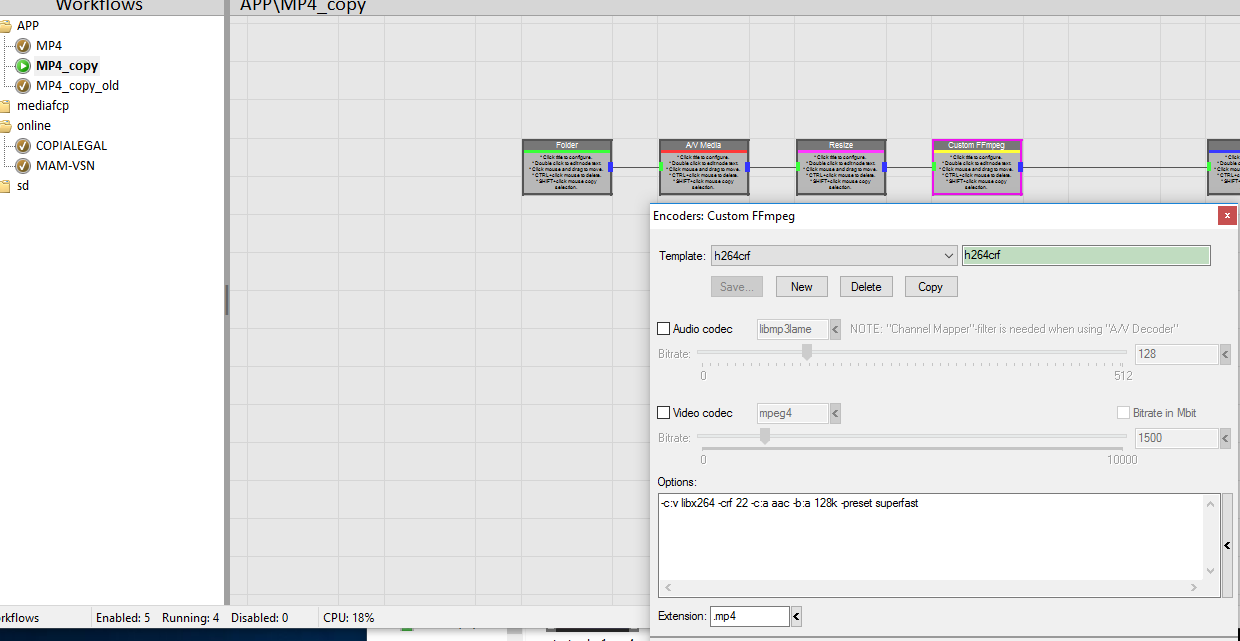

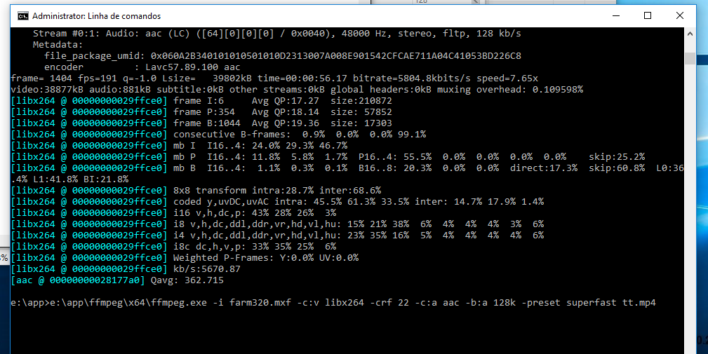

I'm trying to enconde H264 with processor Custom FFmpeg. I tested the ffmpeg instruction in command line and works fine.
When I try to use it in ffastrans I get the error "Encoding failed - No video or audio found in media" (attachments).
Any tip to solve this?

I forgot to insert the ChannelMapper processor. Now is working perfectly.
