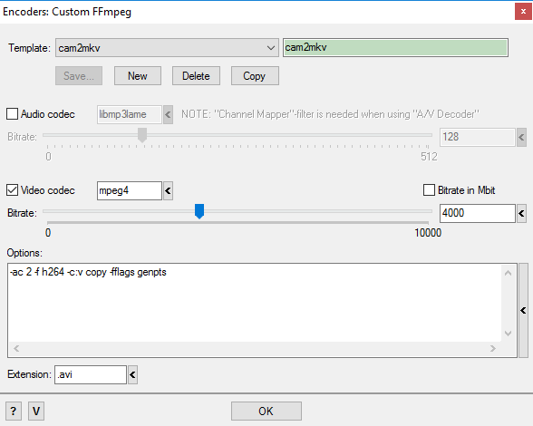

My problem is, that I don't know how to make from this ffmpeg command a working encoder in FFAStrans?
Tried to enter it the best way I could, but it didn't work (attached).

- changed the Video Codec to h264, but still doesn't work.
- the error i get: No audio or video found in media

The first thing you need to make sure is that your ffmpeg command works from a dos command. Also, you must be aware one thing regarding the "Custom FFmpeg" encoder: You can NOT specify options before "-i". FFAStrans does this:
ffmpeg.exe -i "%s_source%" <your command and options are inserted here> -y "output.<your extension>"
If you need to use options before the input "-i", like "-f h264 -i ...", then you must use the "Command executor"-node to create a completely custom ffmpeg command:
%comspec% /c ""%s_ffmpeg%" -f h264 -i "%s_source%" -c:v copy -fflags genpts "%s_original_path%\%s_original_name%.mkv""
This command will execute FFAStrans own ffmpeg executable and use the input delivered to the "Command executor"-node as the source. The ouput will be in the same folder with the same base name as the original source by utilizing the "%s_original_path%" and "%s_original_name%" variables. Be aware of the encapsulation quotes (")
