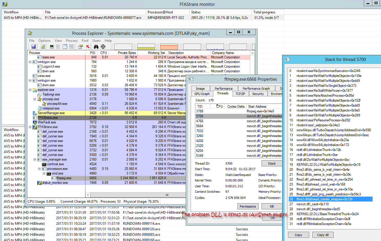

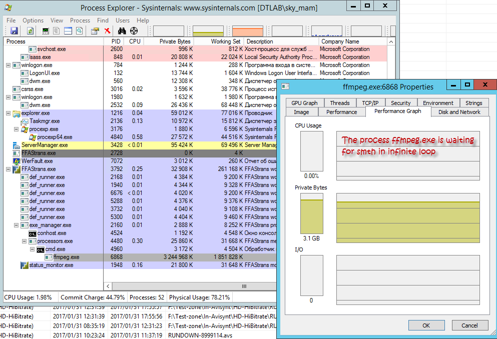

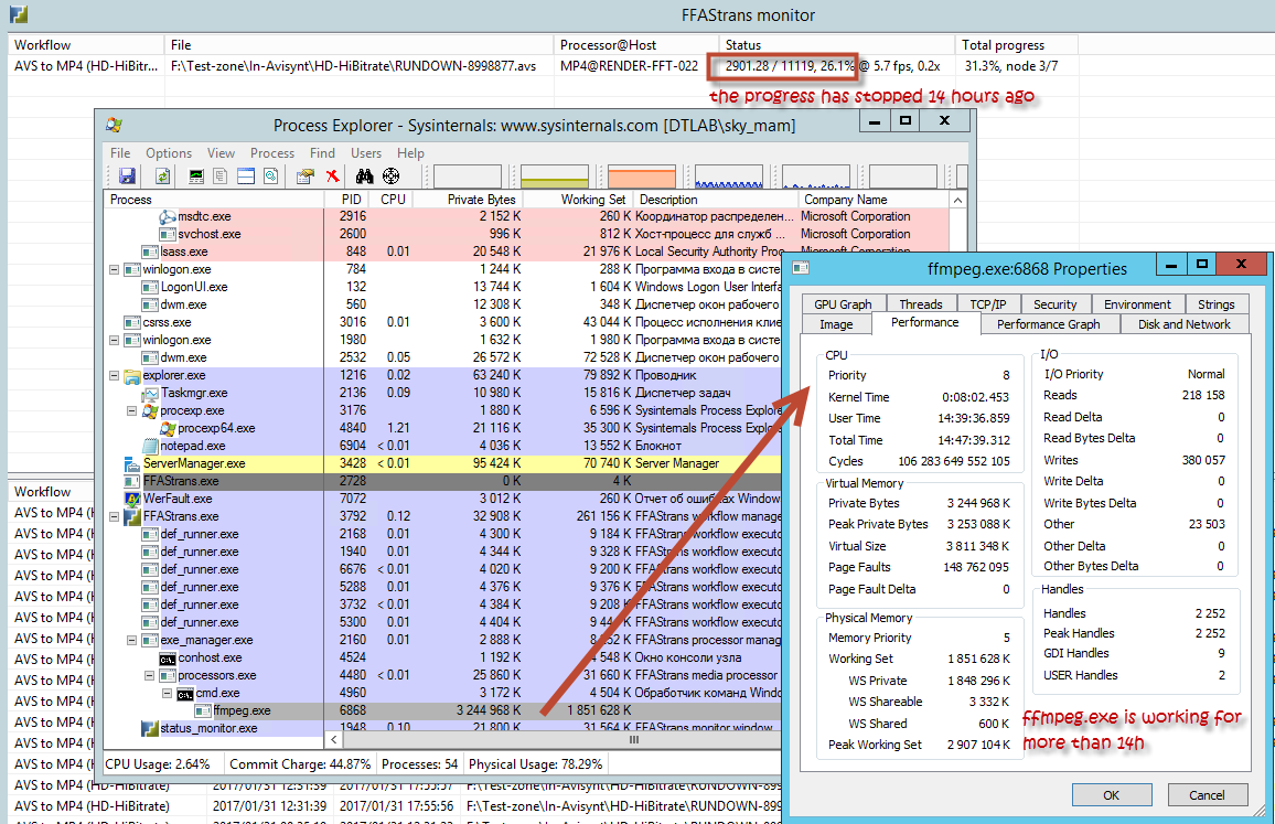

FFASTRANS is seems to be using external AviSynth installation when processing AVS input files. I used the plugin FFMS2.dll which comes bundled with FFASTRANS, and copied it to external AviSynth installation. But sometimes, especially on big files, the encoding freezes in the middle.

Thanks Alexander for your great effort in helping me trying to resolve this. Although I have not yet been able to recreate the issue but looking at your screen shot it looks like ffmpeg is using memory close to what a 32bit applications can manage. Maybe that might be the problem. If so the next version might solve the problem. It sports an experimental 64bit AviSynth+ and test so far has showed some great results, and it seems pretty stable. Anyway I will try and investigate further.
