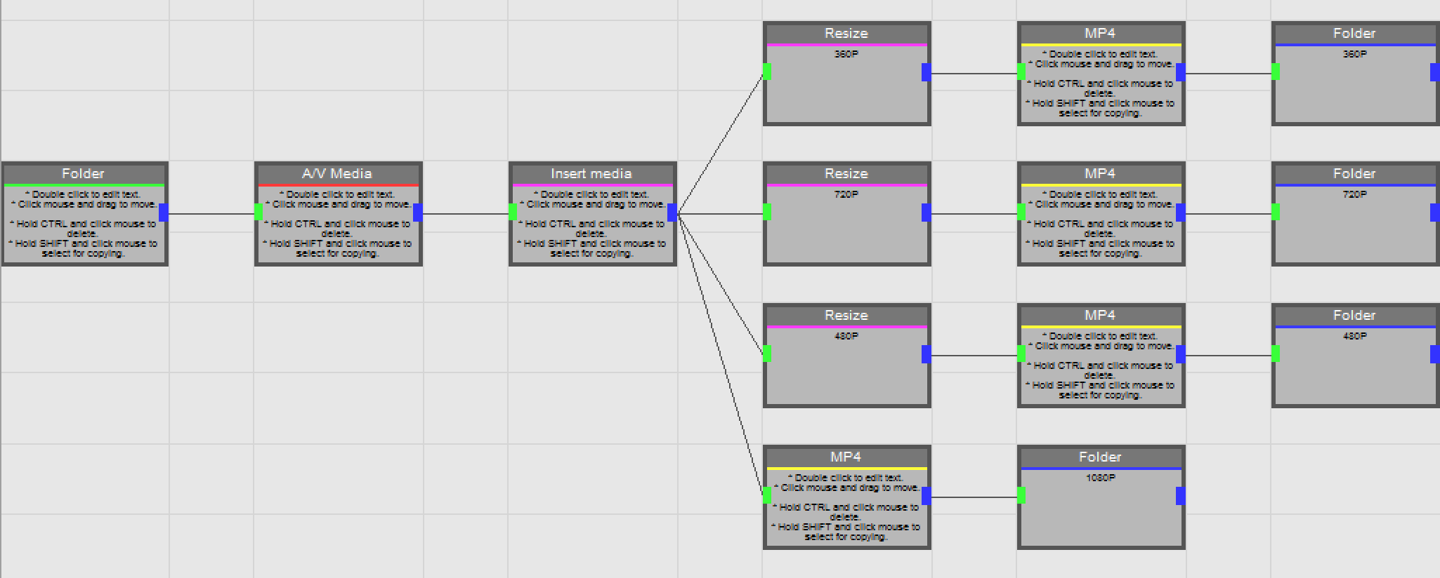

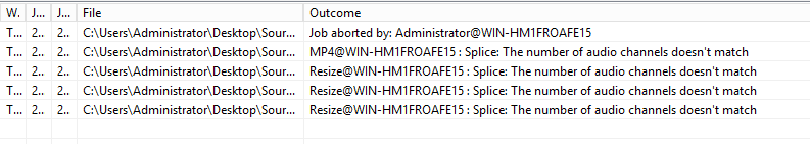

Okay. Thanks for the inputs steinar! Here is my current workflow. However, it seems that the audio channels I'm working with isn't matching. Where do you think is the mismatch coming from? i.e., the intro and tutorial footages' codecs are not matching?
I'm inserting an uncompressed 1080p AVI intro into a 1080p A/V Decoded MP4 video.
Screen Shot 2016-09-07 at 8.55.49 AM.png (106.38 KiB) Viewed 19365 times
Screen Shot 2016-09-07 at 8.55.26 AM.png (52.78 KiB) Viewed 19365 times

So I checked the audio channels, the intro says 2 channels (stereo) while the other end of the file is a 2 channel only. Does this mean this is a 2 channel mono?
Re: Automatically Add Intro to Videos
Ok, the "A/V media"-decoder will always conform the input media to 32 channels in one track. However, the "Insert media"-filter does not adapt very well to the audio configuration. So you must either make sure your intro has 32 audio channels in one track, or you can add the "Channel mapper" prior to the "Insert media"-filter in order to restrict to 2 channels. That should work. I'm sorry but I did not think about this issue in my last reply.
