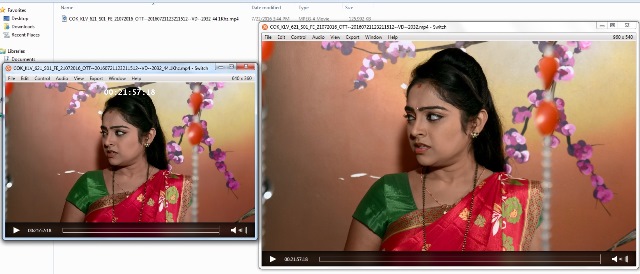

Please find attached screen shot for your reference.
AAC Audio Duration Issue.jpg (172.06 KiB) Viewed 10503 times
I have also checked in encoders MP4 option but output is same.

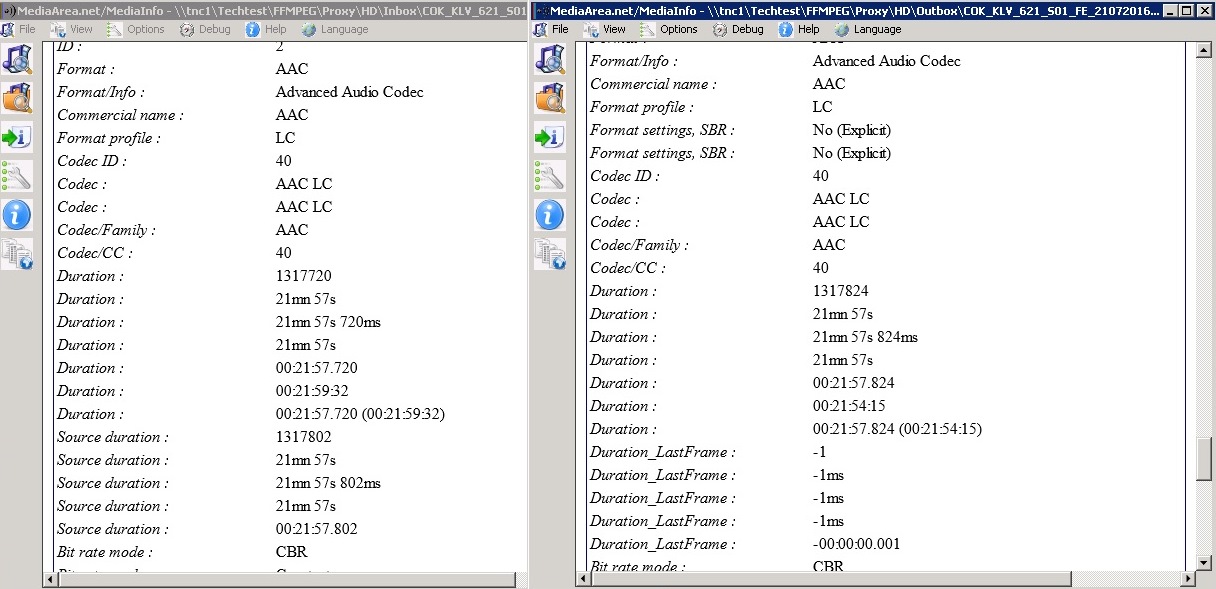

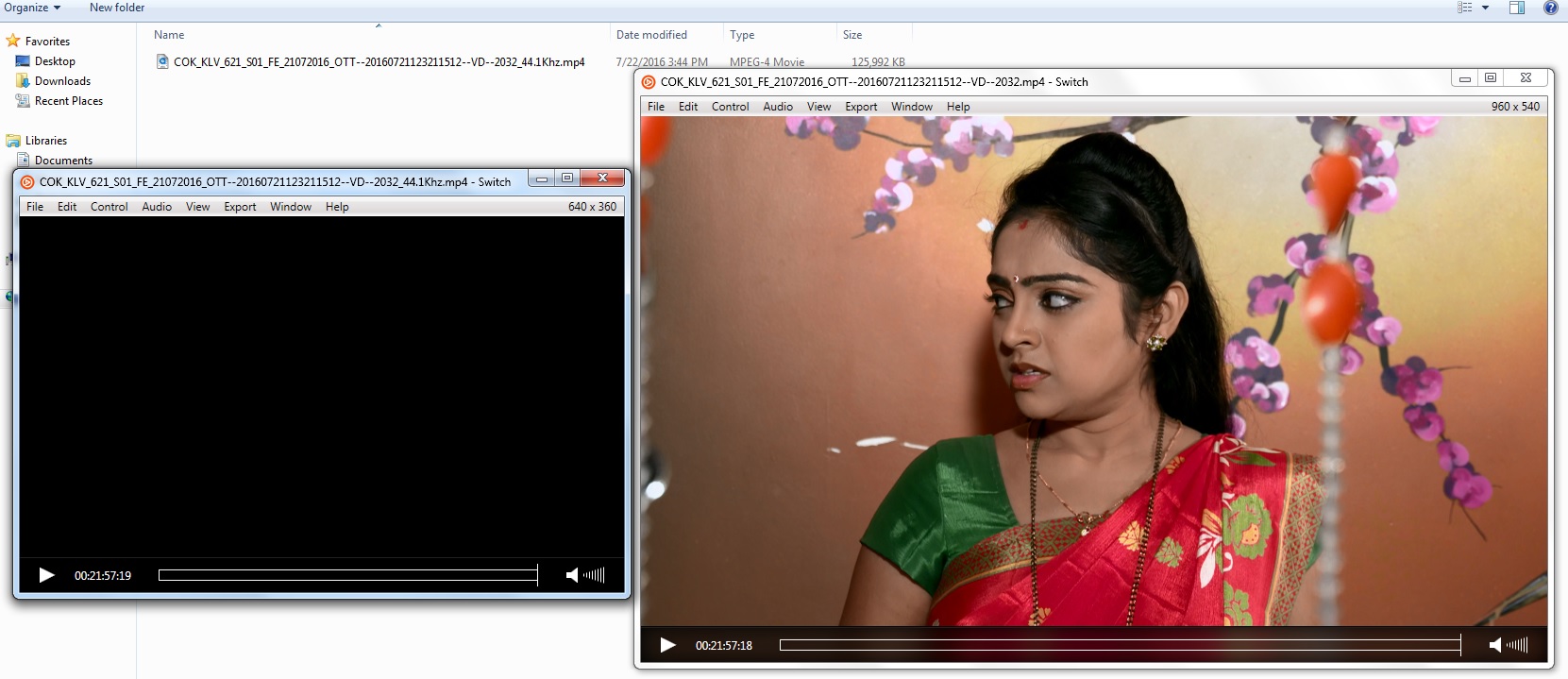

When we play these MP4 files in FCP or Adobe we doesn't observed any issue but when we play them in switch or HTML player we are getting extra frames at the end. Media info also showing extra frames in audio stream.
Please find attached screen shot of Switch player for your reference.
Extra frames at the end.
Can you please suggest if this is an aac codec behavior or some other issue is there.

It's just my opinion but you may want to set fps and use -vsync in that command line. That should access time base during encode.
