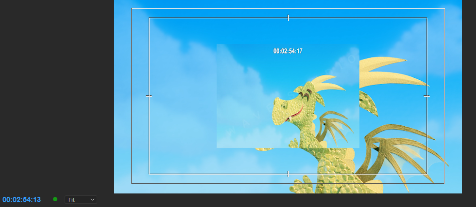

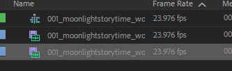

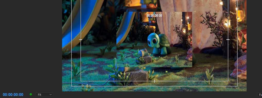

Hi Steinar, would you please check the attached screen shots and let me know if this can be fixed?
on Premiere, the project frame rate is at 23.976
Project FPS.PNG (4.49 KiB) Viewed 16880 times
the project starts at 00:00:00:00
at 00:00:41:16 the clip jumps to 00:00:41:19 "2 frames skipped"
at 00:02:05:04 the clip jumps to 00:02:05:07 "2 frames skipped"
the source file is 23.976 and the timecode node is on the default setting.
after 3 minutes.PNG (363.47 KiB) Viewed 16880 times
Start 00.PNG (712.35 KiB) Viewed 16880 times
Re: Burn in TimeCode
This is easily reproduceable for me: Just take a source file that has 23.976 Framerate and send it to a workflow that has AV Decode->Timecode->Encode->Deliver. Voila, right after 00:00:41:16 (Frame number 1000), the next 2 Frames are missing.
The error seems to come from the ShowSMPTE Function within Avisynth.
This avisynth command, which is generated by the ffastrans "Timecode" processer, will bring up the mentioned error at Frame 1000 (= timecode 00:41:16)
m_clip = ShowSMPTE(m_clip, fps=23.976, offset="00:00:00:00", x=160, y=452, font="arial", size=53, text_color=$ffffff)
Whereas this command will not bring up the error (just the fps Argument is omitted):
m_clip = ShowSMPTE(m_clip, offset="00:00:00:00", x=160, y=452, font="arial", size=53, text_color=$ffffff)
I propose to @admin as a solution, in the "Timecode" node, at the "Force FPS" Dropdown, when the value "None" is selected, then omit the "fps" Parameter for the ShowSMPTE function... at least for a short term solution.
