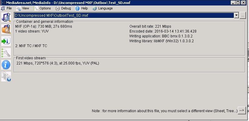

My requirement is to transcode the files into uncompressed format, I am able to trnascode it to 10 bit 4:2:2 YUV using below command in command executor. Now my bit-rate is also around 221 Mbps. I have added option -a 4:3 and -c 10 to provided command.
%ComSpec% /c ""%s_ffastrans_dir%\Processors\mxf_tools\raw2bmx.exe" -o "D:\Uncompressed MXF\Outbox\%s_original_name%.mxf" -a 4:3 -c 10 --unc "%s_source%""
Please find below screen shot for your reference.
Now I am trying to add audio but still not able to succeed.
Please suggest.
Vijay
