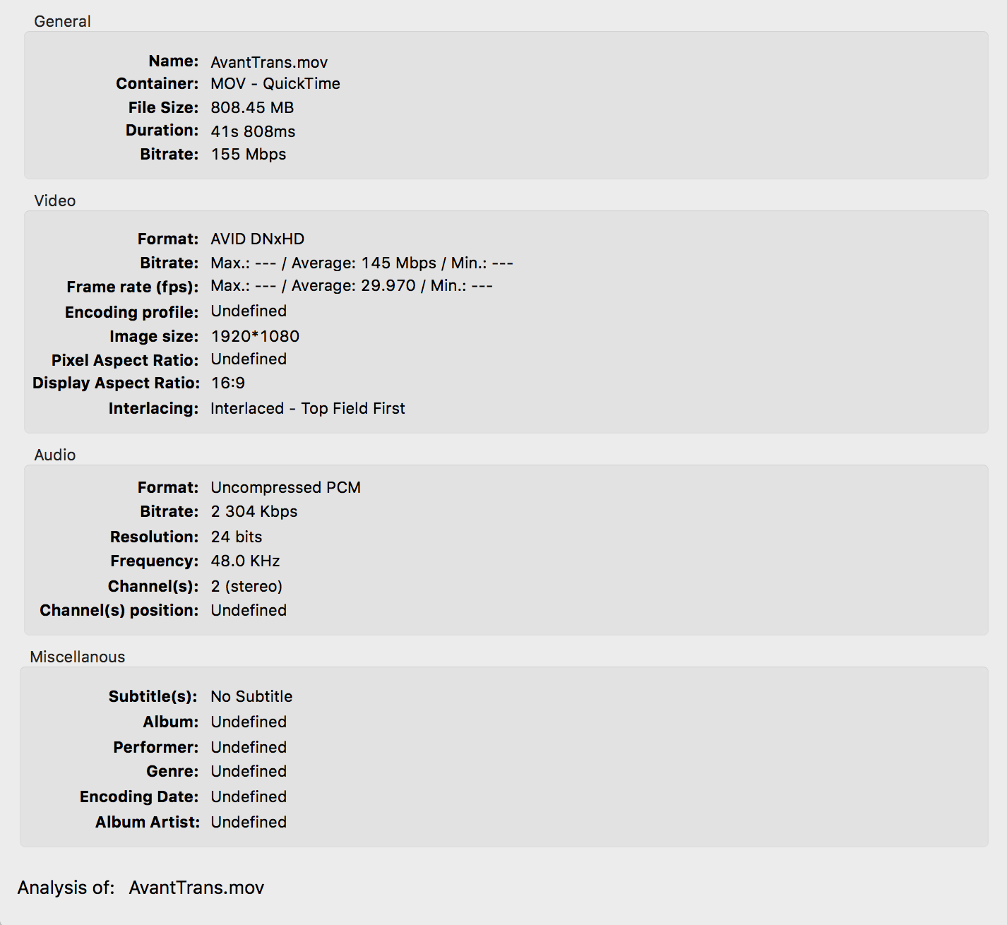

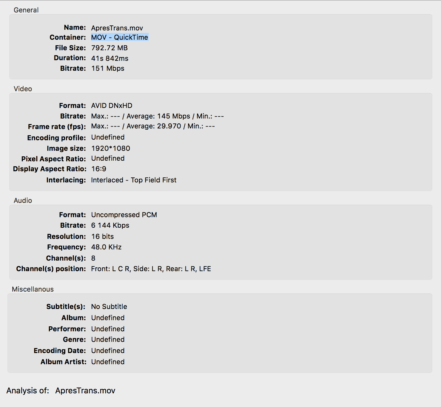

Now, I have to transcode some files back from H264 to Avid DNx145. The video part work great, but the audio doesn't work so well. I don't know how to explain it, but everything end up in the first 2 channels and not sounding correctly. When I open the file in a software, like VLC, it work great. But when I open it in my hardware (EVS server), it doesn't work properly.
I did 2 screens shots, one of a file that is working,
and the one after being transcoded with FFAStrans.
I also tried to use FFmpeg to encode DNx and it didn't work. I used dnxhd for the video codec, I'm not sure if this is the correct setting,
Thanks for all your help !

Update : I've figured how to use FFmpeg to encode a Quicktime with DNx with FFMpeg, I've used these options
-map 0:0 -map 0:1 -map 0:2 -map 0:3 -map 0:4 -map 0:5 -map 0:6 -map 0:7 -map 0:8 -c:v dnxhd -b:v 145M -c:a pcm_s24le -flags +ildct -timecode %m_tc_start%
I can't test the file with my server until Thursday but I think I'm getting closer.
