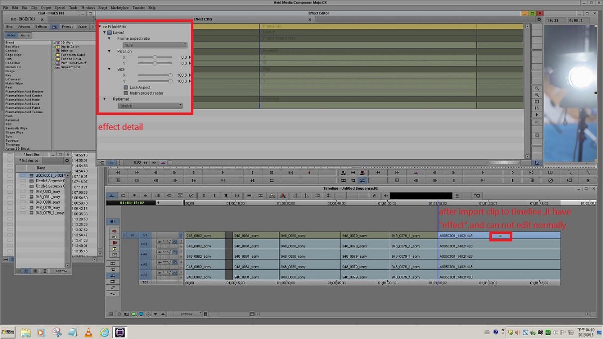

I use FFAStrans to transcode XAVC(Sony FS7) clips to XDCAM50 ,
and import files to AVID Media Composer normally , but drag clips to timeline ,
it have "Frameflex" effect in the timeline ,it cause clip can not edit normally,

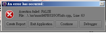

and appears error msg finally.
I use the same XDCAM50 clips to edius to test,it's normal.

AVID MEDIA COMPOSER7.0.3 Frameflex
drive.google.com/file/d/0Bxm-s9C6l1kONms2a044bmdFeVhaWmoxQW1WLTJ3VWRhcU1Z/view?usp=sharing
AVID MEDIA COMPOSER7.0.3 error msg
drive.google.com/file/d/0Bxm-s9C6l1kOWGJUcnhXV1R4djhlZEFwdmxyRG45NU80bkRN/view?usp=sharing

- avid mc error.png (9.7 KiB) Viewed 9963 times
- avid media composer import ffastrans xdcam50 clip.jpg (220.97 KiB) Viewed 9963 times
