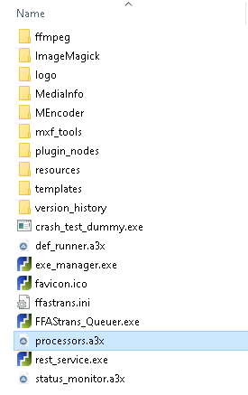

Jokes aside, I raised -qmax to 28 and changed -lmax to "28*QP2LAMBDA" and then I recompiled a new processors.a3x for FFAStrans 1.4.1 Stable.
processors.a3x
(889.69 KiB) Downloaded 1936 times
Copy-paste it in B:\Processors\ in the FFAStrans installation folder
Then trigger the encode again and let me know how it goes.

This is weird 'cause the new processors.a3x actually produces the same command line you're using for the custom FFMpeg script.
The reason why we're still overshooting is probably because of -qmin 1 -lmin "1*QP2LAMBDA", so I'll raise it to 5 and give you a new processors.a3x to test, but before I do that, can you actually confirm that with the command line you posted above you're absolutely not getting any bitrate overshooting problem?
