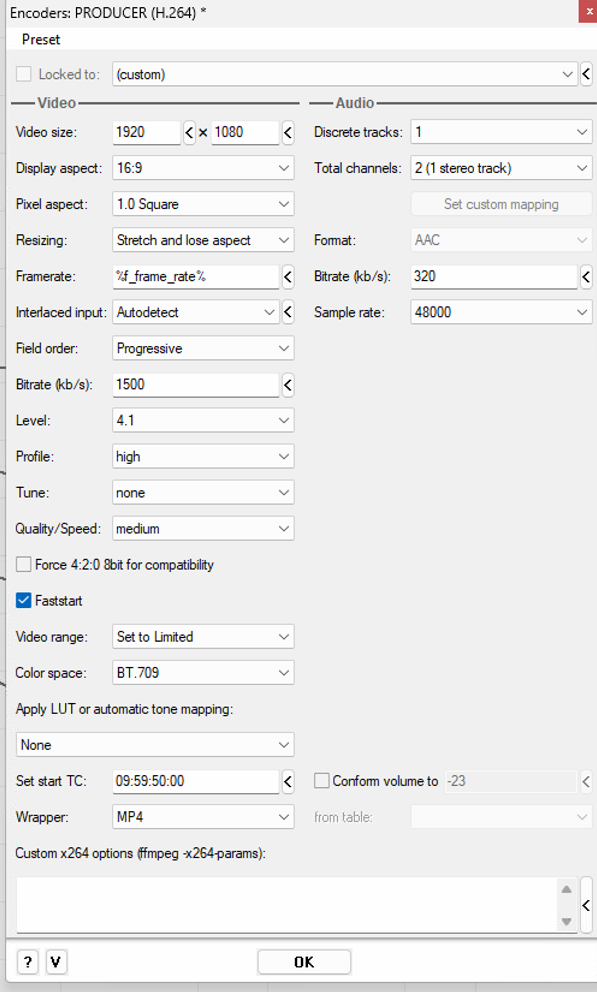

- FFASTRANS MP4 Output Settings
- FFastrans Settings.png (179.93 KiB) Viewed 131919 times

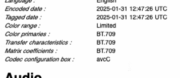

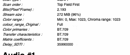

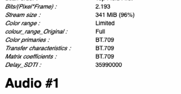

OK easy enough, i was able to find out that the base problem comes from your input mxf. There are 2 different metadata for "video range" in the file, one the mxf header, the other one the video stream headers. MXF says Limited, Video stream says Full. Premiere produced a buggy file actually.
Mediainfo knows both values:
As you already played with the h264 processors range setting, i guess you already had a feeling about it.
Now, as you also already said, it depends on the decoder (e.g. avisynth or ffmpeg) if it assumes the source is Full or Limited range but this is one of the points where many decoders do not follow the rules: the standards say that the metadata from Header should always take precedence over the ones from stream. This again is stupid because we could not pack an SD stream with changing aspect ratio easily in the mxf correctly. We could but the mxf encoder would need to place a new body partition, reflecting the new video metadata. No decoder on earth would support this.
Anyway, avisynth and ffmpeg decoders behave differently in this regards obviously.
What i found out is that
a) the setting in the mp4 encoder "Set to Limited" (or full) does nothing in this case. Not sure what its supposed to do, maybe @admin knows.
b) if it worked in theory, you would need to set "full" because after avisynth, the clip is marked as full, so you'd need to just keep that in the encoder for preventing conversion.
c) there is some strangeness regarding the ffmpeg filter "format" actually, this seems to be the one that performs the range conversion, this filter is not there when you encode to 4:2:2 output but it is there for your mp4 and it seems to be the one that executes the range conversion, again @admin might be interested.
d) due to a very recent change in ffastrans (change setrange to setprop filter), i believe the problem might be accidently fixed in future ffastrans versions, we need to check that internally.

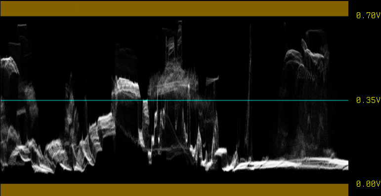

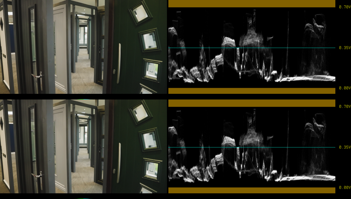

Here's the interesting part: you have the H.264 encoder with the following option "Set as Limited" which means that the filter_builder will do absolutely nothing to the input levels before passing the uncompressed A/V stream living in RAM to the x264 encoder. The only thing that setting does is to set the metadata in the output file as Limited TV Range.

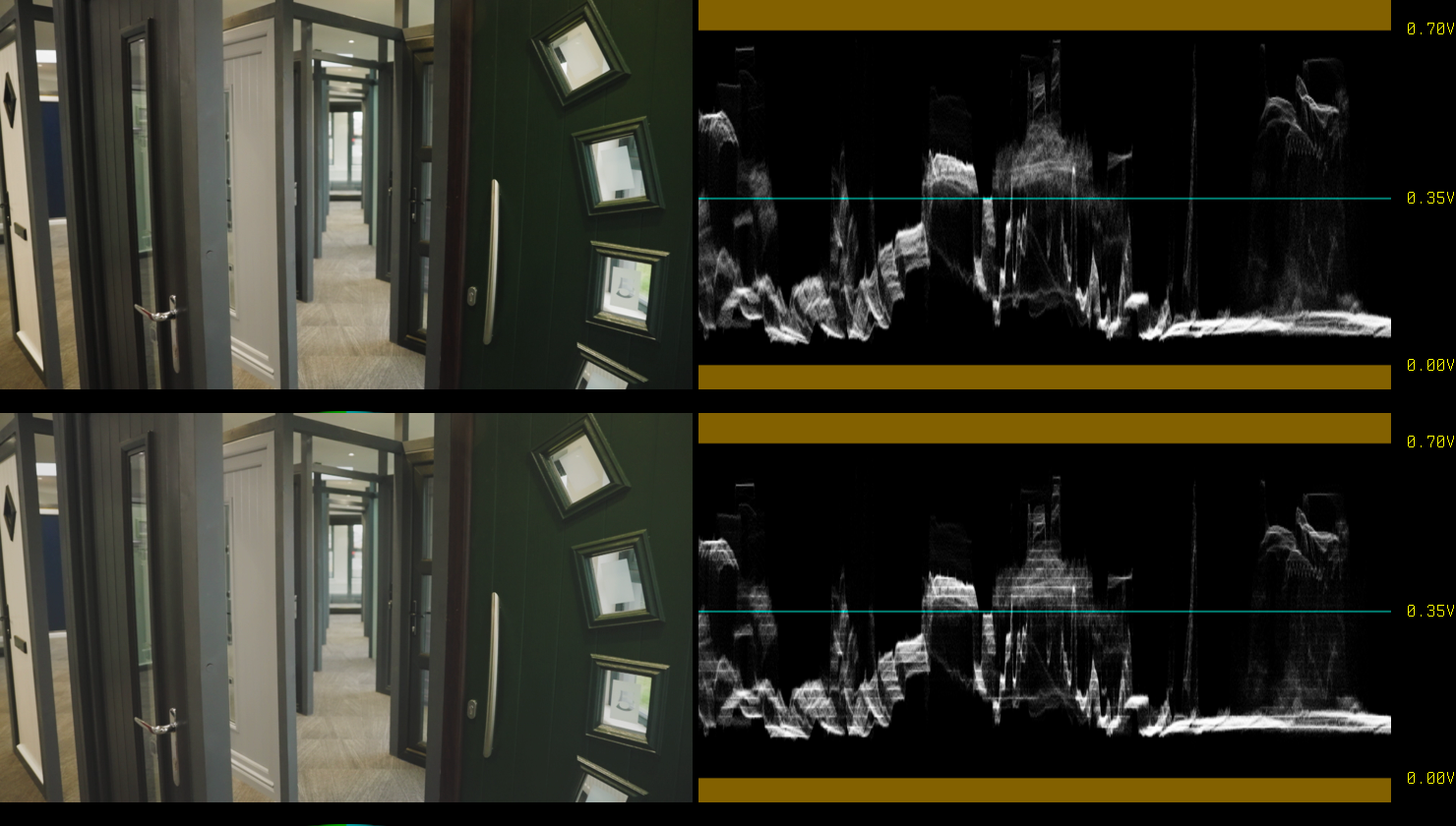

I downloaded both samples (the source and the encoded one), indexed them and then I used VideoTek() to see the waveform:
Top is the original AVC Intra Class 100 file with the normal limited tv range levels and the bottom is the output H.264 file with the wrongly compressed levels.
Emcodem already found the issue with the source, which is that it has contradicting information between the stream and the container where one says that it's limited tv range and the other says that it's full pc range, in fact Adobe Premiere exported a raw_video.h264 with the metadata saying "Full PC Range" and then it muxed it in an .mxf container saying "Limited TV Range". But... here's the thing: as long as you have the H.264 encoding node on "Set to Limited" the encoder won't touch the levels, but rather it will just leave them alone and just set the metadata, which is what is happening here.
If you look at the waveform from VideoTek() above on the encoded file, you can actually see that not only it's been compressed twice despite being limited tv range already, but I'm like 90% sure that it has been converted inside Avisynth itself. The reason why I'm saying this is that there's only one function that I know for a fact introduces those "lines" (the horizontal stripes you can see in the waveform) and that function is Levels(). If this happened on the filter_builder level in FFMpeg, we wouldn't have had those "lines" (i.e horizontal stripes) but rather a different waveform. This is corroborated by the fact that by having the encoder set with "Set to Limited" it won't mess with the levels.
Here's the AVS Script created by the A/V Decoder:
There's absolutely nothing wrong here.
Even ConvertToYUV422() won't screw it up 'cause it thinks that it's full pc range so it will just use matrix="PC.709" instead of matrix="Rec.709" under the hood, thus leaving the levels alone.

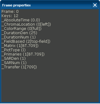

Frame properties after the Avisynth Script: As you can see, it's set to Full PC Range (i.e _ColorRange == 0) instead of _ColorRange == 1, but it's "fine" 'cause the levels are untouched:
Here's the comparison of the input source alongside the output produced using your simple workflow: Here's the outputted sample: https://we.tl/t-NKR9b6HTMl
Please note that all I said above is true as long as you have A/V Decoder -> H.264 Encoder, however it might not be true if you add additional nodes using Avisynth like A/V Decoder -> Filter X -> H.264 Encoder as the internal logic might be performing different adjustments according to the metadata, but yeah, it should work.
Anyway, please take 1.4.2.10 for a spin and give it a try.
