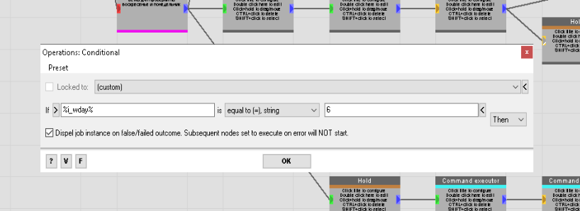

Dispel job instance on false/failed outcome didn't work for conditional processor on FFAStrans v1.4.0.7 & webinterface 1.4.0.85:

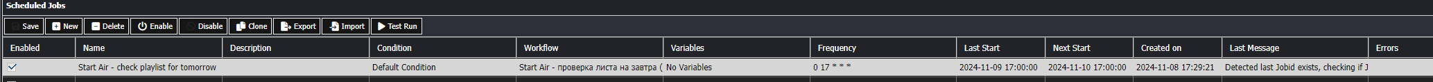

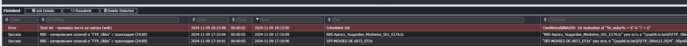

Workflow started by web scheduler:
Снимок экрана 2024-11-09 182853.png (17.62 KiB) Viewed 25054 times
On FFAStrans v1.3.1 & webinterface 1.3.9.0 it's ok.

Re: FFAStrans v1.4.0.7 - Dispel job instance on false/failed outcome not working
That was reported recently by @momocampo too, it is fixed now but until i am happy with the performance regression, you will have to wait a few days i fear.
Thanks a lot for reporting, the report was as usual very clear and straight forward!
