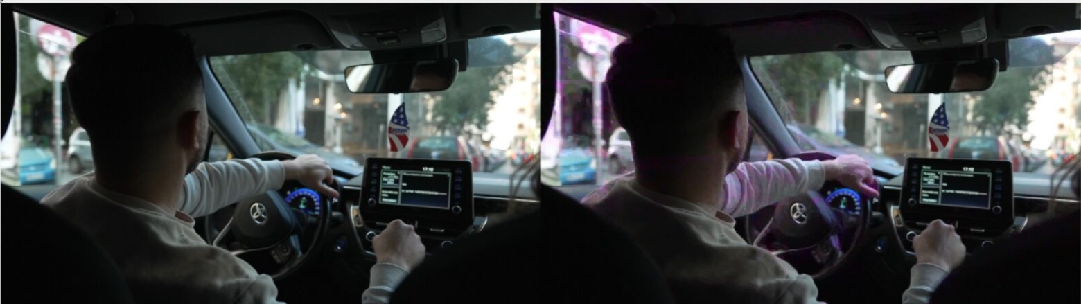

Funny enough i stepped over this topic very recently and i sticked to SSIM because i just assumed vmaf might be slow by design. At the end of the day i learend that SSIM is a lot worse as i was already aware it is:
SSIM: 0.946235481
ME: this cannot be the real ssim value, this must be a joke... :? The picture looks completely different
SSIM: yeah, you know that i don't calculate values about how the pictures differ from human perspective, right?
ME: :roll:
