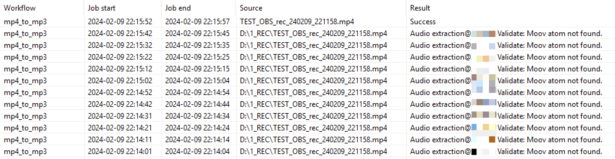

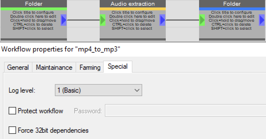

After several days of working with the new version 1.4.0.1, I encountered a problem (bug) with monitoring growing files continuously - the workflow is trying to process the file while it is being recorded using OBS or vMix, without waiting until the write is complete and the file is finalized!
And this visible in the log - error "Moov atom not found".
But it is possible that this is just a problem with the log display (full log view) in Status Monitor & Webinterface
File successfully processed after record was stopped.
2024-02-09_Remote Desktop Manager-002038.png (106.28 KiB) Viewed 38835 times
2024-02-09_Remote Desktop Manager-002040.png (32.43 KiB) Viewed 38823 times
mp4_to_mp3.json
(4.13 KiB) Downloaded 1645 times
Re: FFAStrans 1.4.0.1, Monitor growing file issue
Hey my dear,
check growing continuously is a very very special option, it is designed to start a new job whenever the input file changed so it looks like it works perfectly for you :D
Check growing "Once" is what you normally want. If this does not work because the input file is changing size too slow, we'd need to add the waiting inside the workflow actually... let me know if "once" works for you.
