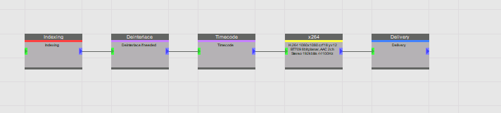

I created a workflow like yours: and went on re-encoding a file similar to yours.
I checked the first 10 seconds and I couldn't find any duplicates:

The fact that the file has duplicated frames might be because it was VFR originally and it was brought to CFR by the indexer, but with no logs, no workflow and no source, I can't reproduce.
https://we.tl/t-cWIJ01G6r2

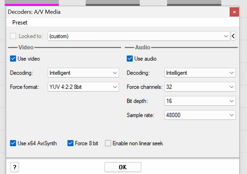

Upon further testing, it is the Decode AV Media node being set to 'Intelligent'. It works in 1.3.0 fine, but it's throwing the stuck frames in 1.3.1
I'm positive I set this to Full Decode in previous testing, and it didn't sort it. Anyway, I've run a few tests with the above MXF AVC file and 1.3.0 'Intelligent' decode works fine, but in 1.3.1 it's throwing the stuck frames.

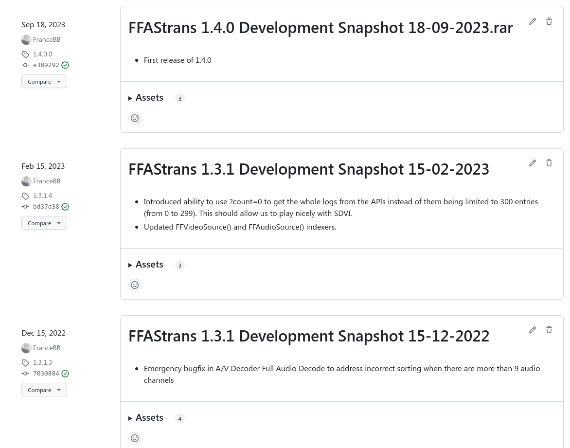

Uhmmmm looks like there has been some misunderstanding/issue on our internal Github as apparently the official 1.3.1 stable got shipped with a faulty version of the indexer, while my 1.3.1 had the right one, 'cause I imported your workflow and the file came out just fine.
I'm not gonna lie, our internal GitHub is a bit of a mess right now, but hopefully we'll bring it back to a sane state by the end of the 1.4 merge window.
Anyway, this was your file and your workflow ran through my FFAStrans 1.3.1 Development Snapshot 15-02-2023: https://we.tl/t-8Hh53civYJ
As you can see, there are no repeated frames at all.
For graham728:
Here's a copy of the build I used, namely FFAStrans 1.3.1 Development Snapshot 15-02-2023: https://we.tl/t-yZUuB008Dz
(link expires in 7 days, please test it again using this build)
For everyone else:
It will be fixed in 1.4, I'm so sorry about this.
For graham728:
For everyone else:

No, the one you find in the download page of the website is still the old one, we didn't perform any other upgrades compared to last time, but you can use the 1.3.1 development snapshot build from February 15th 2023 I sent you last time which addressed the error.
If you want I can re-upload it, no biggie.
That's because February 15th 2023 was the very last time we worked on 1.3.1 before forking to 1.4.0
If you mean if it's fixed in 1.4.0, instead, of course it is!
But... 1.4.0 ain't public yet as it went through some major redevelopment work and there are lots of new features we tested since September 18th 2023, when the first non public 1.4.0 development snapshot was created.
The "latest and greatest" development snapshot is currently the one from January 16th 2024 called RC92 (i.e Release Candidate 92) which also includes some pretty neat optimizations on the DB operations done by Grandmaster, BUT it's still not ready to become public and I'll have to create a new build as Grandmaster has pushed some more fixes and improvements.
But yeah, 1.3.1 development snapshot from February 15th 2023 has it fixed and you can use it, while for everyone else, when you upgrade to 1.4.0 (when it will be released) it will also be fixed
