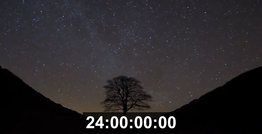

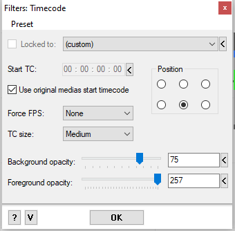

I am trying to burn-in the timecode on videos we export. We edit in Premiere Pro and our timeline starts at 23:59:50:00 to allow a 10 seconds slate at the beginning, so that the actual program starts at 0:00:00:00.
This works in Premiere Pro, however, if I tell FFAStrans to use the clip's original TC as a start, the TC goes to 24:00:00:00.
I searched the forum but couldn't find any previous request about this, would you be able to help?

Hi Railio, thanks for reporting this :-)
This is default behavior of the ShowSMPTE filter in avisynth. Obviously one should be able to make sure it's reset to 00:00:00:00 instead of continuing to 24:00:00:00. We will have to address this in the next version and work around the inbuilt limitation of the ShowSMPTE filter.
