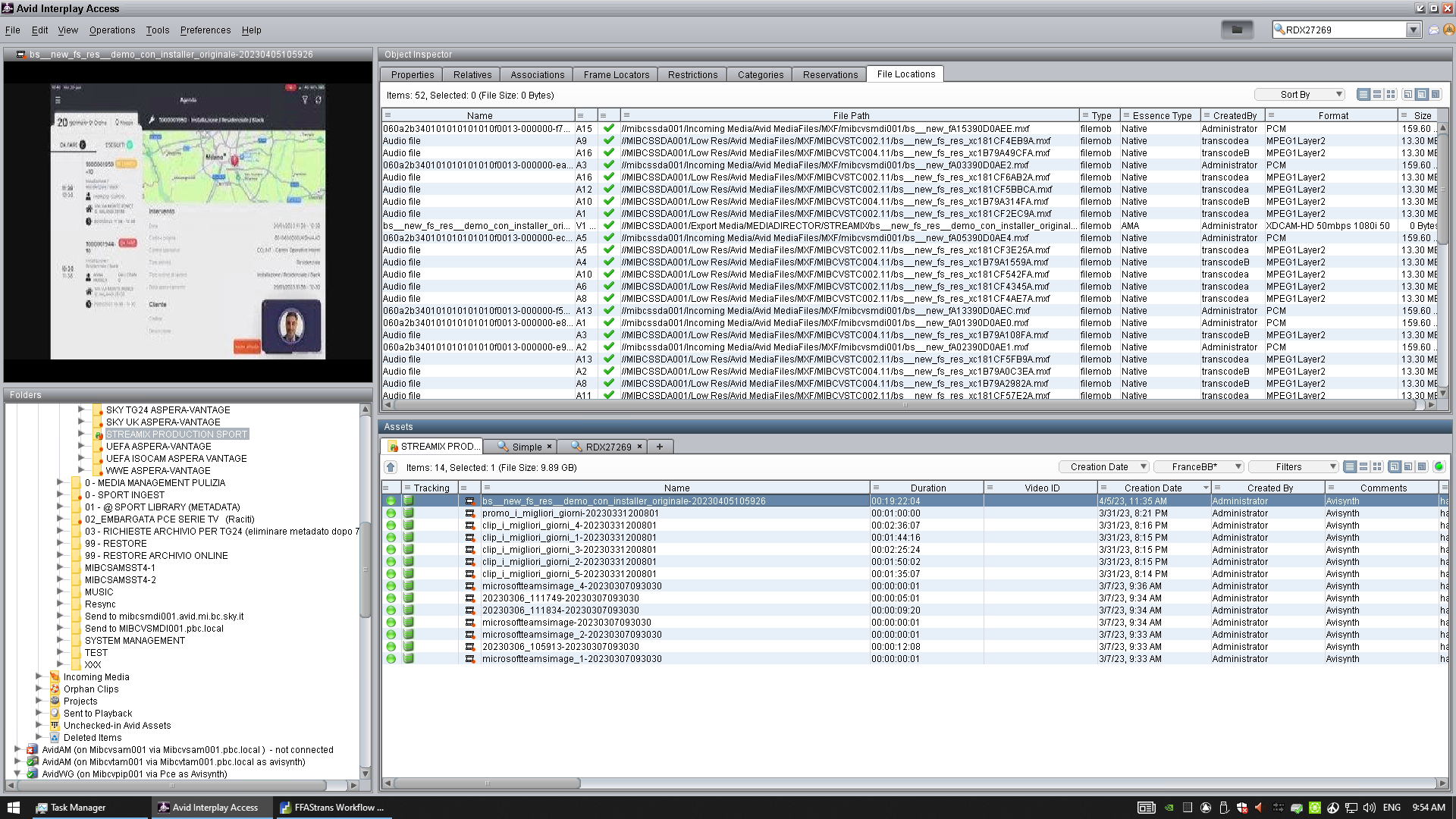

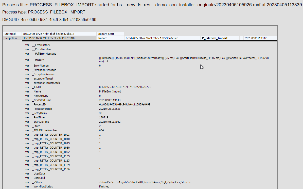

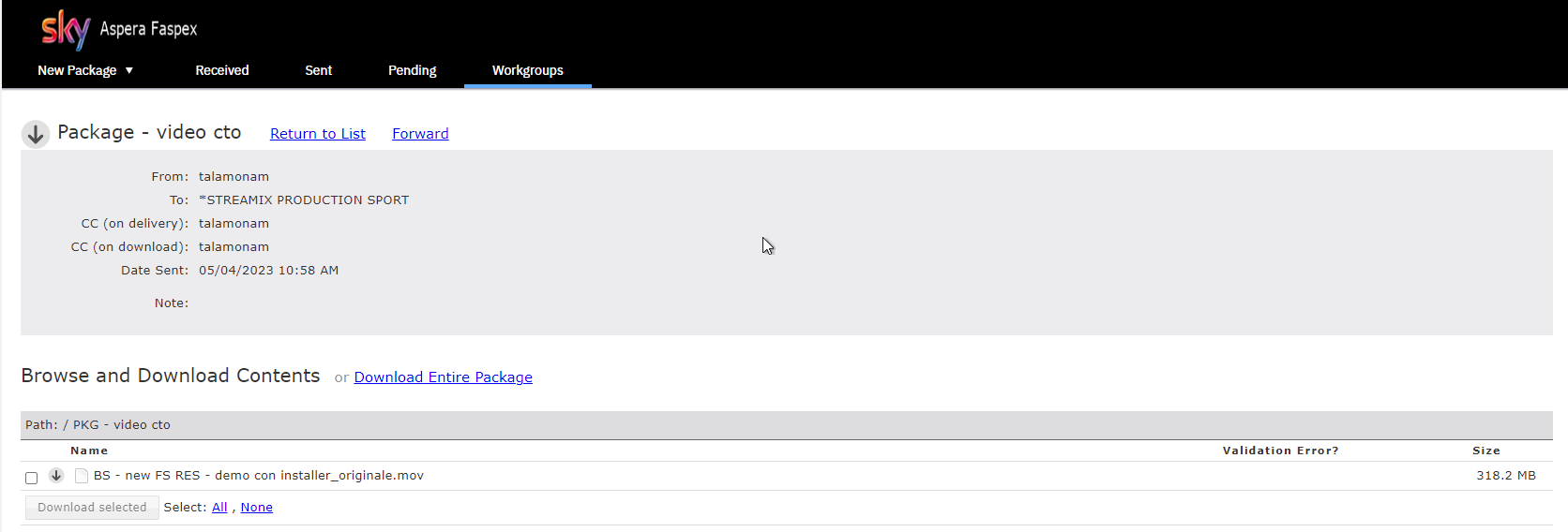

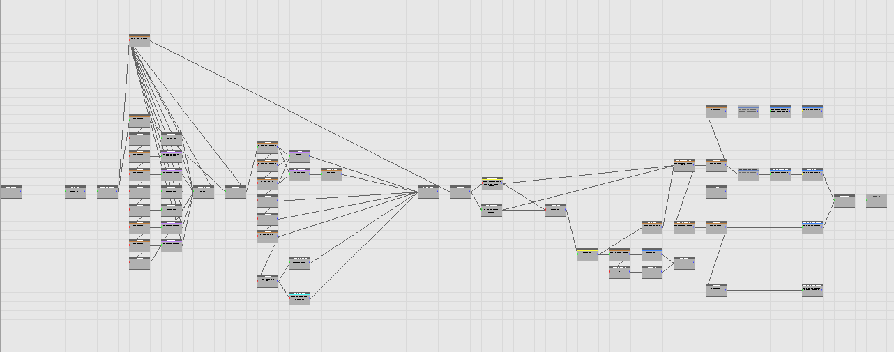

By the way, I gotta tell you that link and consolidate into Nexis can be done automatically and that's exactly what we're doing.
Let me show you a workflow called "Streamix".
This workflow receives files which people upload to Aspera.
Those files are downloaded using Aspera Orchestrator and then passed to FFAStrans through an REST-API call.
FFAStrans starts, does its bit of Avisynth magic with some logic and eventually creates an XDCAM-50 .mxf file.
Such a file is then passed to AVID Mediadirector which consolidates the asset to the Nexist storage (incoming media workspace) and checks that one into AVID Interplay. ;)

and sure enough the file is now consolidated in a workspace:
Screenshot from 2023-04-07 08-54-21.png (345.44 KiB) Viewed 17457 times
