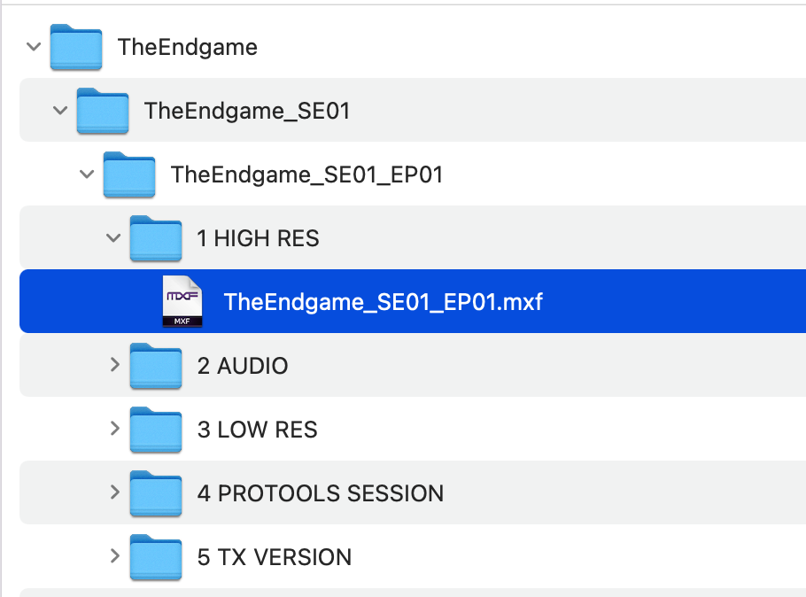

i need your help to define a final delivery process in my workflow, which creates a subfolder structure based on the naming convention of my source file.
Usually the naming convention of my file is:
TheEndgame_SE01_EP01.mxf
ie:
Tile_Season_episode_description
what I need, is to create a subfolder structure where i copy the file like the following:
Tile
Tile_Season
Tile_Season_episode
my file
just to better understand
Screenshot 2022-12-04 at 06.35.52.png (116.06 KiB) Viewed 7145 times
i am trying using a populate metadata process before delivery process but i can not assign the correct parameters, can you please help me ?
thanks

Hey ring4life70, good to hear from you again!
No problem at all but the method that i use assumes that the characters _SExx and _EPxx do not occur in the %s_tile% part (xx means 2 numbers). If you fear it could happen that this could occur, let me know because we probably need another strategy.
Populate processor: (you have to "create" the corresponding user_variables that i use here on the left side:)
%s_ep_description% = "1 HIGH RES"
%s_tile% = $regext("%s_original_name%","(.+?)_SE\d\d")
%s_tile_season% = $regext("%s_original_name%","(.+?)_EP\d\d")
%s_tile_season_episode%  = %s_original_name%
Note that the order of these instructsions does not play a role. $regext, explained:
() = use only the part inside the paranthesis. If we would not use (), e.g. we write the regex like ".+?_EP\d\d", the matched portion would include the _EP\d\d part.
.+? = this is my favourite regex, most of my regexes contain this. it means match everything up to or between. In our case as we start with .+?, it matches from "start" until what i worte after .+? (e.g. _EPxx)
_SE\d\d = match everything from start up to _SE followed by 2 numbers
Delivery processor:
Folder = \\server\share\%s_tile%\%s_tile_season%\%s_tile_season_episode%\%s_ep_description%
Of course if you prefer you could just omit the variable definition for %s_ep_description% and instead write in the delivery processor like this:
Folder = \\server\share\%s_tile%\%s_tile_season%\%s_tile_season_episode%\1 HIGH RES
On a sidenote, you store the title 3 times in the folder structure and 1 time in the filename, is that really neccessary? Wouldn't a folder structure like "Title\SE01\EP01" do the job?

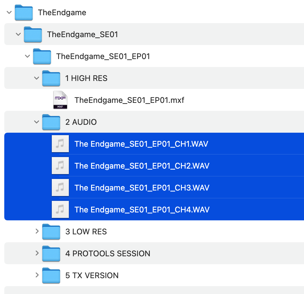

thanks for your time, the populate node works as desired, thanks again, however I have another issue, when I go to extract multiple audio CH from a file I have to move all the extracted tracks to the same folder as you can see in the screenshot below:
Screenshot 2022-12-04 at 21.46.16.png (163.4 KiB) Viewed 7106 times
as you can see for the audio file we are using the same naming convention with the addition of the description of the CH Audio.
for all the audio files the naming convention is:
TheEndgame_SE01_EP_01_CH01.wav
ring4life70

solved :D
i changed the variable, %s_tile_season_episode%
from:
to:
%s_tile_season_episode% = $regext("%s_original_name%","(.+?)_CH\d\d")
and used the following formula in the delivery node:
D:\LOCAL STORAGE\%s_title%\%s_title_season%\%s_title_season_episode%\AUDIO
