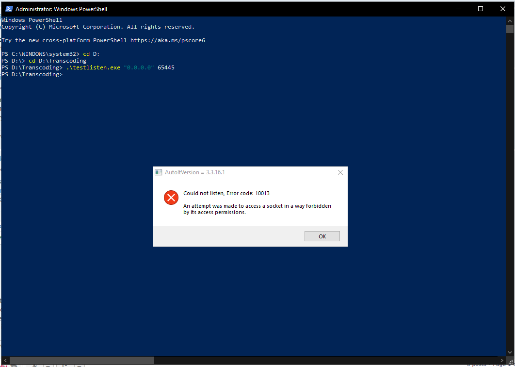

That testlisten.exe also presents an error:
I made sure ffastrans service and application was shutdown before running it.
This is probably a specific issue to my windows install. Some edge case.
