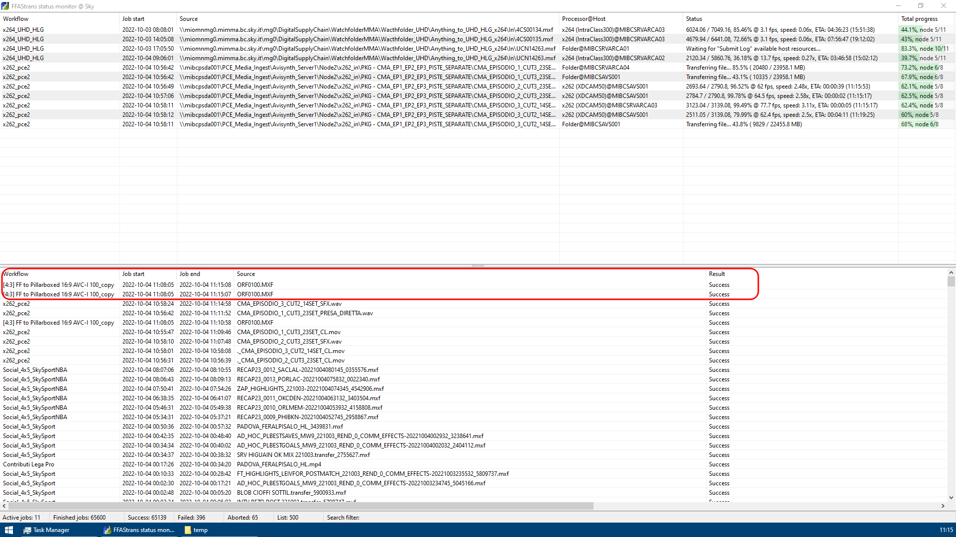

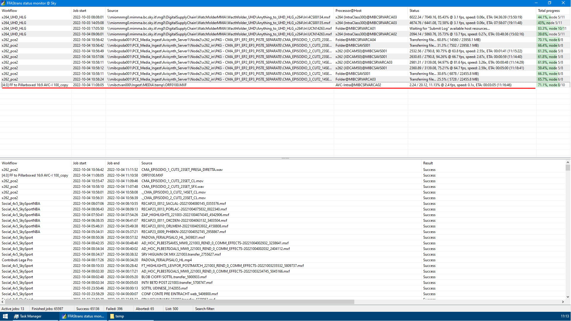

Re: System exception - Illegal Instruction - Possible issue with resize module
Ok, so, I've got your workflow and it's fine in the sense that it completed successfully on my end as I tested it on the same servers I use in production:
