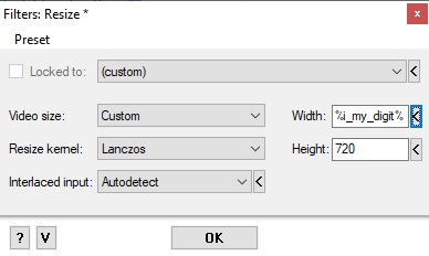

it's it posible to use the resize tool and give only the width a value? so that the computer itself determines the height based on the aspect ratio?

Hi video_m,
You can sort of easily do the computation yourself by storing the calculated width or height in a variable.
For example, if you want to resize 1080 video to 720 you can do the following in the Populate node.
%i_my_digit% = (%i_width%/%i_height%)*720
The result of this would be 1280 if source was 1920x1080. %i_my_digit% being just some arbitrary variable you create yourself and you use it as input for the resize width in the Resize node.

admin wrote: Mon Aug 01, 2022 8:26 pm Hi video_m,
Hope this helps.
Hello Steinar,
I have try this solution but i get back a error back. "Could not get value for %i_my_digit%!
Did you know what i do wrong?
Thank you.

video_m
Posts: 22
Joined: Fri Dec 17, 2021 6:07 pm
Re: Resize with only one value
Post by video_m »
i found the mistake. i forgot the av-media deencode :)
