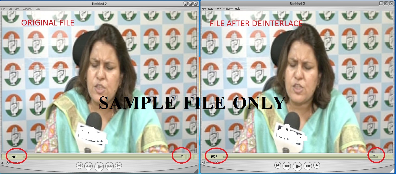

After Deinterlace 2 extra frames added and these frames played black using Quick time player. Also no information for last 2 frames. This is for all. please help.

Thank you very much for your quick reply. I am very much new to use FFASTRANS. I am sending all the details to you. My problem is not only for a particular file. 2 frames added to every file when converted/deinterlace using FFASTRANS.
Please help/guide me to resolve the problem.
i am sending two files sample files also ORIGINAL(ORIGINAL---assam8.MOV) and converted file(AFTER DEINTERLACE----assam8 DY365.mov). Please download the files from https://we.tl/t-IzJDkfxBUi

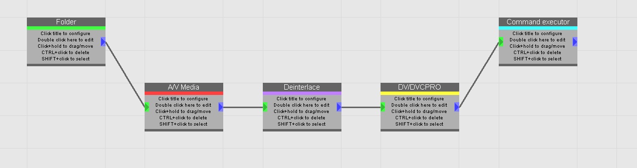

MY WORKFLOW.jpg (92.73 KiB) Viewed 17820 times

So from what i see, the problem is related to using mov container in output: there is more audio than video, also there is more audio than there was in the input file.
This problem seems to exist in ffmpeg since a very long time and i am not sure if this can/will be fixed anytime so i suggest a workaround for you
1: ignore the problem, quicktime for windows player is dead and most players will ignore the superfluous audio data OR:
2: In the encoder processor, set mxf as output wrapper format. This guarantees that there is exactly as much audio as there is video. After the encoder processor, insert commandline processor with this commandline:
"%s_ffmpeg%" -i "%s_source%" -codec copy -y "C:\temp\%s_original_name%_delivered.mov"
You can change "c:\temp to your desired delivery location. also i added _delivered to the output filename, you can just delete that or replace by some other suffix.
Let me know your thoughts.
Sidenote: i am not sure if you need A/V decoder and deinterlacer in your workflow at all, the encoder processor should take care about input conversion automatically but you might know better why you do it like this.

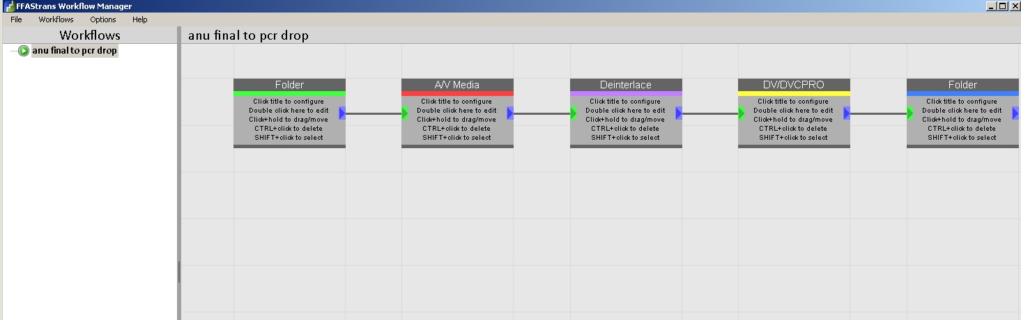

My present workflow is like...
Sir, I already told you that I am totally new to 'FFASTRANS' so I do not understand your hint actually
Another hint: if your goal is to correct "wrongly flagged" files, e.g. files that say they are top field but in reality they are bottom field, you can again toss the A/V decoder and in the encoder processor just enable "Interlaced Input: Analyze".
My aim is to correct only the files with interlacing problem or otherwise not. In my case, I think presently all the files are getting processed. I am sending my workflow.json file and I will be very happy if correct my workflow and send back to me.

Re: Black appears at end after deinterlace
What kind of problem? Is it just about wrong metadata in source files, e.g. the flag is bottom field but reality is top field or is it something totally different?
Do you have 2-3 short source files for us that show the problem you want to correct?
