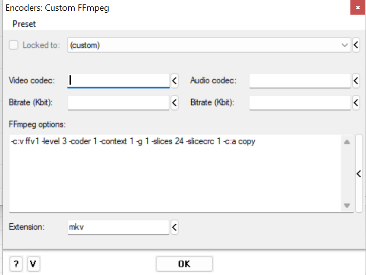

Hey James,
welcome to the Forum and thank you for using FFAStrans!
Personally i prefer a cmd executor over custom ffmpeg processor because it limits me far too much and it is kind of hard to debug but i tried it out and didnt find any issue using your parameters:

Hello emcodem, thank you for such a quick response!
I have now tried laying out the commands all on one line as you did and I have success! It was my formatting that was wrong.
Thank you ever so much for your help.
