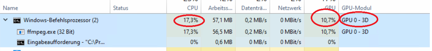

As you know ffastrans itself has no knowledge about all this. So you'd need to check if ffmpeg is using the hardware qsv manually by just doing a transcode like
%path_to_ffastrans%\Processors\ffmpeg\x86\ffmpeg.exe -f lavfi -i mandelbrot -c:v h264_qsv c:\temp\out.mp4
As i dont have any machine where it runs with software h264_qsv, i cannot tell you how to determine if software or hardware encoding is used, except you check in taskmanager cpu/gpu (video encoder) utilisation.
As you can see, h264_qsv looks like this, hevc_qsv would burn some more percent of gpu utilisation (funny enough it says it uses GPU "3d" engine even if it uses the video encode engine).

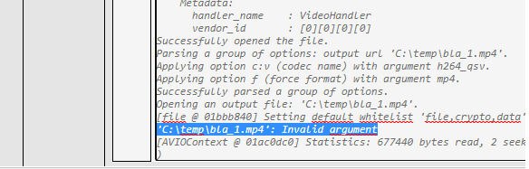

Using your command unmodified (besides output path), submitting a file and using webinterface to see the output of the spawned command line revealed this:
After changing the single quotes to double, it ran but it didnt show any gpu utilisation.

%comspec% /C ""%s_ffmpeg%"  -c:v h264_qsv -i "%s_source%" -c:v h264_qsv -f mp4 -y "C:\temp\%s_original_name%_1.mp4""
Note that i removed also -loglevel debug just in order to remove noise and also i change the ffmpeg path to the one that comes with ffastrans. You don't need a custom build just for utilizing QSV or NVENC, it is contained in every standard build these days. Also i added -y as usual in automation in order to avoid potentially forever hanging ffmpeg, waiting for me to confirm overwrite of the output file.
