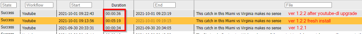

Upgraded to version 1.2.2, post upgrade I found that workflows utilizing the youtube-dl processor were taking a very long time to complete. Found that the version packaged was out of date 2021.4.17. After manually upgrading youtube-dl by running youtube-dl.exe -U the workflow times returned to normal.

Noted. It's weird, though, that it completed the job but just took longer for it to be completed.
Anyway, I'll check the version shipped and we'll make sure to ship an updated one when 1.3 will be released (time to check GitHub).
Unfortunately I don't use the YouTube dl node so I've never tested it honestly, otherwise we would have caught it before the release.

I agree, odd turn of events. I expected to roll back the whole install to 1.2.1 but I decided to try the easy thing first, and for once it worked. Since FFAStrans 1.0 youtube-dl gets updated daily automatically, had I not bothered to test a few clips it likely would have gone unnoticed.
