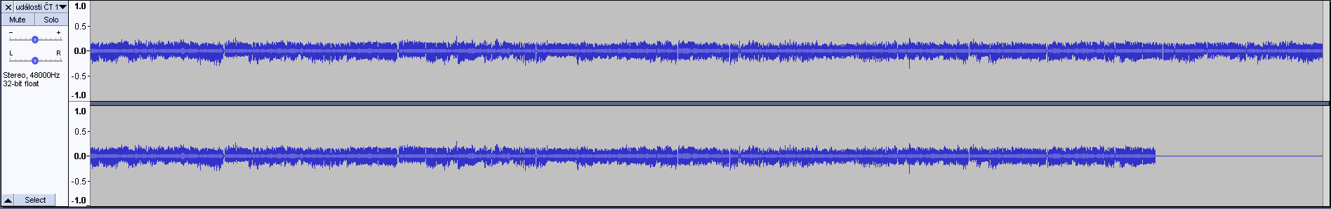

If the size of source 8 track WAV file is above 2GB, then the operation in AviSnyth fails to create the audio file corectly: Odd audiotrack (A1) is correct, but Even audiotrack (A2) is incomplete (audio ends up earlier). See the screenshot from AudaCity attached.
AviSynth processed WAV file - A2 ends earlier then A1.PNG (25.01 KiB) Viewed 16680 times

yeah wav and filesize are not the best friends... anyway interesting bug for ffms2 you found there. Not sure if the creator of ffms2 avisynth plugin ever added support for rf64 which would be the extension needed to come around the original wav size limit.
I just tried it and was able to confirm the behaviour that you describe, with one difference or better clarification: The second track is silent from a certain point but the first track is also not what it should be, it's crippled.
