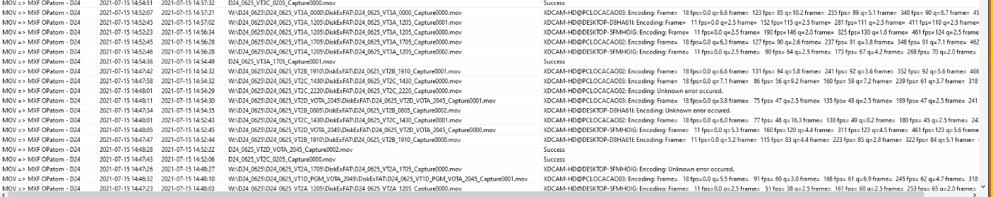

The serious one:
It showed an error during XDCAM transcode, then all of the jobs started the next node - delivery at the same time, no job was done when that happened. And after a while it shows this error. The weird is that somejobs complete! It happened to all farm stations. I stopped the job, switched back to local and apparently its not happening anymore.

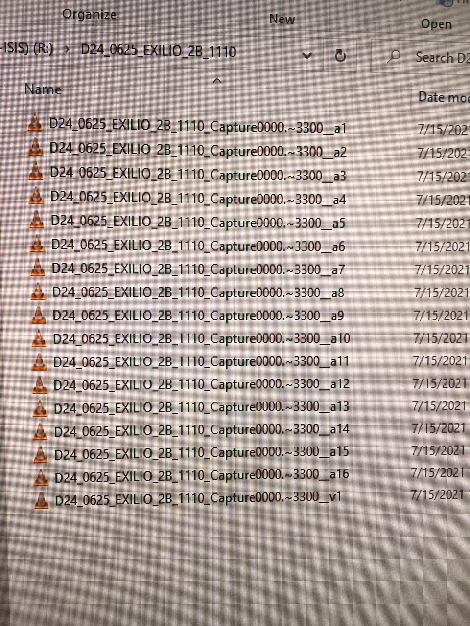

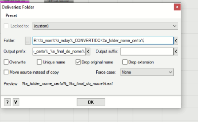

I've enabled the "move source instead of copy", but the filenames started having a weird "~3210" at the end of the filename. I looked into it and saw that this "~1234" thing also appears on the file inside the workfolder in CACHE. I disabled the "move source instead of copy" and it stopped. Any idea why ?

The serious one:
- Deliver folder node
- delivery folder.PNG (32.41 KiB) Viewed 18765 times
- Rename files
- rename_move_files.jpeg (315.29 KiB) Viewed 18765 times
- The first problem
- encoding error.PNG (396.64 KiB) Viewed 18765 times

So, apparently there was some weird stuff happening. I restarted the workflows and FFastrans, updated just to make sure everything was the same between the farms, and it is working. So never mind I guess... but the files are here anyway.
About the first major problem, I don't know why, but It only happened when I uses ISIS as the work root folder. I switched to another NAS and it didn't happen anymore.

What you said was correct, the problem was with the ISIS share, as soon as I switched to a NAS it performed a lot faster, specially the CREATING AVID COMPLIANT part. I would like to test using local drives to set up for cache folder, but this PCs have 250gbs of NVME storage, when this project is over. I will install another NVME drive with bigger capacity and run some tests to compare. But for now, I'm using a NAS with 10gbps connection, even though it is not SSDs, it does perform quite well.
