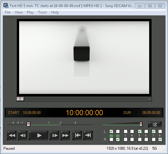

I need to burn the TC into the video by using Timecode Filter. It works correctly for IMX50/MXF videos, but incorrectly for XDCAM HD422/MXF videos. I've found out, that for theese videos the variable %s_start_tc% indicates start timecode value 00:00:00:00 despite the fact that json %s_info_mediainfo% reports TimeCode_FirstFrame value 10:00:00:00.
Attached please find the text files with values of %s_original_name%, %s_start_tc% and %s_info_mediainfo%.
I should also mention, that Sony XDCAM Viewer app displays start TC 10:00:00:00.
Any idea why theese two values are different?

Variable %s_start_tc% indicates zero based TC but %s_info_mediainfo% reports TimeCode_FirstFrame 10:00:00:00
- XDCAM HD422 clip - TC 10-00-00-00.txt
- (27.8 KiB) Downloaded 581 times
- XDCAM HD422 clip - TC 10-00-00-00.PNG (225.15 KiB) Viewed 10174 times

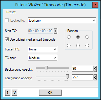

Maybe a stupîd question but did you check the start tc inside the timecode filter? It could be a trap because the default value is "00:00:00:00" and not the source file start tc (%s_start_tc%). You have to change that if you want to be ok with your input file.

The Timecode filter has "Use original medias start timecode" option checked.
And the workflow affected works correctly for IMX50/MXF files.
- Timecode Filter.PNG (10.26 KiB) Viewed 10162 times

Ok you're right, there is a bug.
This bug will be fixed in the next release, the 1.2.1.
