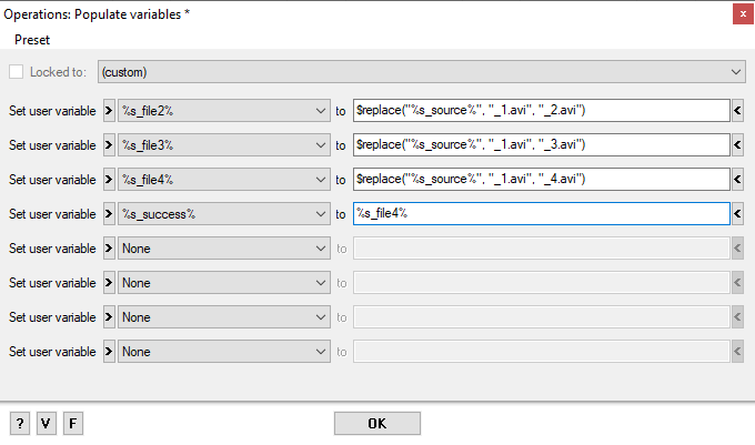

FFAStrans always works with the concept of a single source file. OK there is also support for P2 and CanonXF which consist of multiple sources but what happens there is basically that the input files are magically merged into a single file BEFORE the job is started.
The single source file is in your workflow in the %s_source% variable. Look here for more information about %s_source%. http://ffastrans.com/wiki/doku.php?id=v ... ]=variable
How it could work for you is that you elect one of your 4 source files to be the "master" file and use it for triggering the Job start, e.g. you set your monitor folder processor to watch only for *_1.avi.
Second, you use the %s_source% in order to calculate the filenames of the other sources, e.g. *_2.avi, *_3.avi ... Use a populate processor like that:
In above example, i replace _1 from %s_Source% by _2, _3 and so on and the last thing i do is to set %s_success% to one of the calculated variables in order to see the result on the job monitor "status" field of ffastrans (for development).
Alternatively you can try and use the files find processor to locate all the files and populate their names into variables: http://ffastrans.com/wiki/doku.php?id=c ... processors
What you must do next is to write your avisynth script using a write text file processor. It needs to load the source files and do all your stacking and or whatever you want to do. In order to be compatible to the stock nodes, at the end of your script you must "return m_clip" containing the resulting video and audios.
This is untested but it might give you an idea about my thinking.
