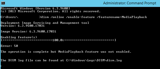

Hi Emcodem,
seems that MediaPlayback feature is not runnin gon my server 2012 r2.
error 50.png (10.36 KiB) Viewed 19448 times

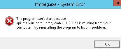

3/ find below screenshot of error message after kicking command:
after clickin gon OK button I get this:
Problem signature:
Problem Event Name: APPCRASH
Application Name: ffprobe.exe
Application Version: 0.0.0.0
Application Timestamp: 00000000
Fault Module Name: n-core-libraryloader-l1-2-1.dll
Fault Module Version: 6.3.9600.18725
Fault Module Timestamp: 59380775
Exception Code: c0000135
Exception Offset: 00000000000ece60
OS Version: 6.3.9600.2.0.0.272.7
Locale ID: 6153
Additional Information 1: ac05
Additional Information 2: ac0507478d1c5bd693cfc4fe3987e900
Additional Information 3: ac05
Additional Information 4: ac0507478d1c5bd693cfc4fe3987e900
Read our privacy statement online:
http://go.microsoft.com/fwlink/?linkid=280262
If the online privacy statement is not available, please read our privacy statement offline:
C:\Windows\system32\en-US\erofflps.txt
and this:

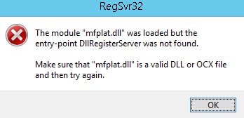

I tried also to register the dll in case of and I get this error message:
