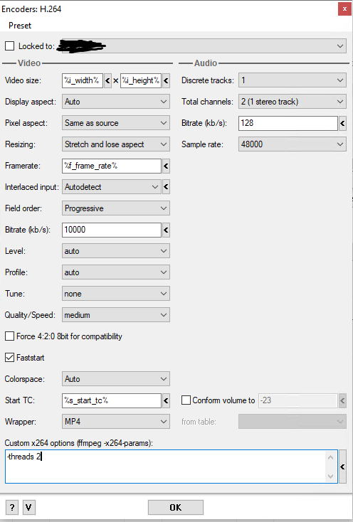

I was wondering if it is possible to write the command in the custom X264 option? Image located below.
Annotation 2020-05-29 153745.png (42.77 KiB) Viewed 26085 times

First of all thank you very much for the reply.
Okay first of all I did try this
threads=8
. However, I could see all the course fluctuating.
Sorry to sound like a complete dance, but do I have to put more than just
threads=8
in?
Would greatly appreciate an example I will be sending that to those being YouTube channels I hope

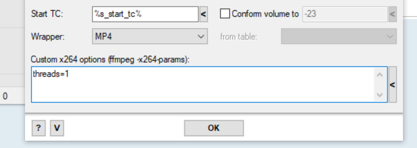

emcodem wrote: Mon Jun 01, 2020 7:47 am Hmmm, i guess you dont have to input "more" but different, did you e.g. try something like
threads=1
Hello, I did give it a go. However, it seems not to work, :?
I set it to 4 threds as you can see. I did also try 1 as well as 2 threds.
Any help would be grateley appriciated.
authorleon
Posts: 108
Joined: Fri May 08, 2020 5:18 pm
Re: Limit the number of cores/threads
Post by authorleon »
I have also tired the follows:
-threads 1
-threads 1
threads=1
threads=1
With and without spaces just incase.
Hey,
no need to test other configurations than exactly this one:
Unfortunately i cannot reproduce your problem, on my dev laptop with 4 cores, setting threads=1 limits the encoding speed to 1,5 while threads=8 encodes with 5x speed.
Your screenshot shows that you do lots of different stuff while testing. Can you please try one single encoding isolated and compare the final encoding speed?
