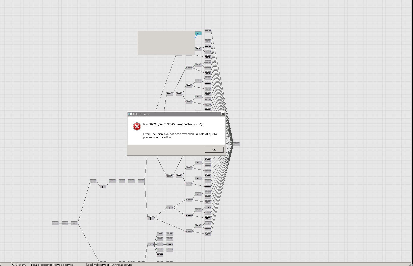

I was able to create the workflow fine without error, but then I deleted a few processors and then tried to add a new connector and I get the Line 58774 error. If I deleted a processor and then try to delete another I get the second error Line 58504.

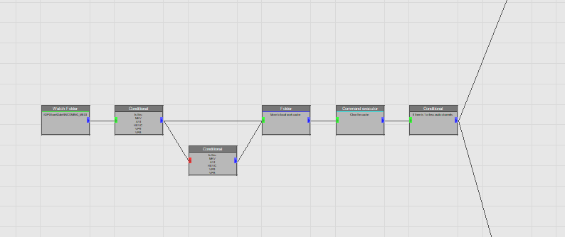

I found a workaround which is delete some connectors first, then I can delete processors or make some new connectors all I want without errors. The errors only occur after first having a huge amount of connectors and processors and then deleting a processor. If I get rid of some connectors first, its fine.
So I've come to the conclusion that my problem is too many connectors. As you can see my workflow is a little intense, so it actually doesn't surprise me.

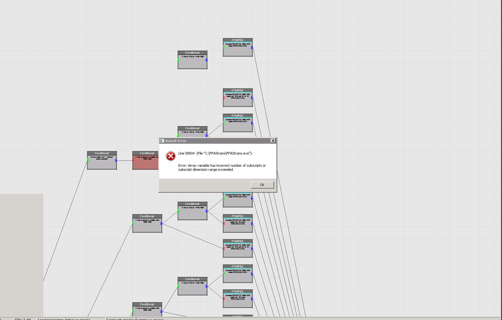

- Error 2 Line 58504

- Error 1 Line 58774
- ffastrans_error.JPG (212.34 KiB) Viewed 20014 times

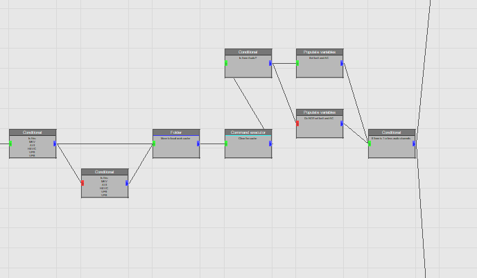

i spent some time checking what you do with all the nodes and i am under the impression it would be better for you to get in touch with variables. This way you might reduce your workflow to 1-3 encoding nodes only.
For example, to get started, lets reduce all the "is there no audio" nodes and also reduce half of the encoding nodes:
1) take a deep breath, get a coffee, backup your existing workflow
2) insert one "is ther no audio" conditional in the main branch (before fps check)
3) insert 2 "populate" nodes in the main branch after the before inserted "is there no audio" check

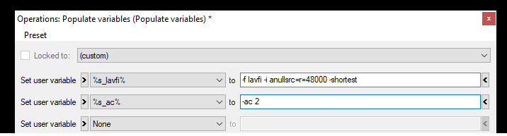

4) in the success path (there is really NO audio), set 2 user variables:
5) in the error path's populate parocessor, set the s_lavfi and s_ac variables to "nothing"
6) both populate connector's outputs are connected to the "there is 1 or less audios processor
6) delete all ffmpeg nodes for the old "no audio" path and all "is there no audio" conditionaly before the encoding nodes
7) alter the old "there is audio" ffmpeg command from this
to this:
You see? ...all i did was inserting the variables %s_lavfi% and %s_ac% into the existing "there is audio" ffmpeg command. If the variables are set, audio will be created, if not, we go with the contained audio..
%s_lavfi% = -f lavfi -i anullsrc=r=48000 -shortest
%s_ac% = -ac 25) in the error path's populate parocessor, set the s_lavfi and s_ac variables to "nothing"
%ComSpec% /c ""%s_ffmpegx64%" -i "%s_source%" -c:v dnxhd -vf "scale=1920x1080:in_range=tv:out_range=tv,fps=30000/1001,format=yuv422p" -vsync 1 -b:v 145M -c:a pcm_s24le -ac 2 -ar 48000 "M:\DPShare\Aurora\DNxHD Profile\output\QC Pass\%s_original_name%.mxf""Code: Select all
%ComSpec% /c ""%s_ffmpegx64%" -i "%s_source%" %s_lavfi% -c:v dnxhd -vf "scale=1920x1080:in_range=tv:out_range=tv,fps=30000/1001,format=yuv422p" -vsync 1 -b:v 145M -c:a pcm_s24le %s_ac% -ar 48000 "M:\DPShare\Aurora\DNxHD Profile\output\QC Pass\%s_original_name%.mxf""...i am pretty sure we could delete of most of encoding nodes by using further variables for fps, resolution and encoding settings (bitrate)

Noqras, I found the cause of the first bug and it was a nasty one!
It's fixed and I'm testing now. The second bug is probably related but I have not been able to reproduce that one. I will send you a patch for you to test when I'm done.

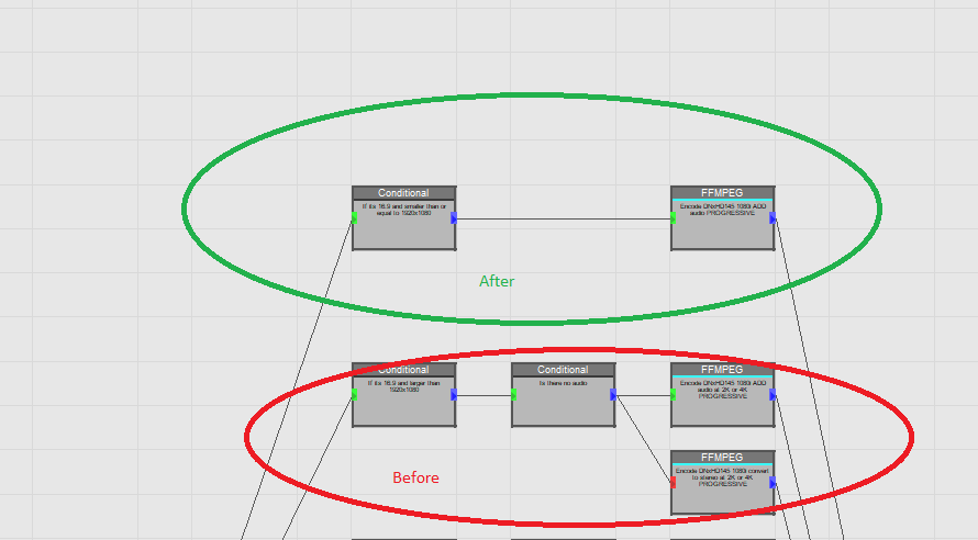

I have removed 1/3 of the encode processors by leaving a lanczos flag on all processors thus being able to remove the redundant processors for 4k and 2k, then using variables for audio that you laid out will make this much more efficient.

I also have a workflow with (too) many nodes. Now I cant delete nodes anymore and get the error message
Line 58504... Array variable has incorrect number of subscripts or subscript dimension range exceeded. I have no backup version with fewer nodes ):
Could you help me repairing my existing workflow? I deleted most of the connectors, but still get the error message when trying to delete nodes.
