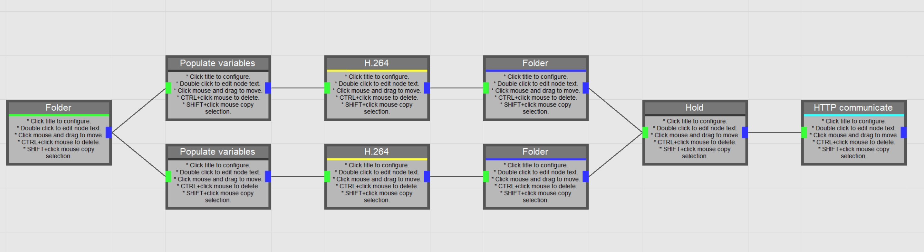

I'm trying to build a workflow that ends with a single success notice sent out via an HTTP Communicate node after a branching workflow has created two proxy files from the original. It looks like this:
Single Hold.PNG (554.93 KiB) Viewed 3660 times
The hold is set to Synchronize, however once both flows have reached the node to proceed, they both call the HTTP Communicate step, so I get two notifications.

Is there a way to merge the branches back into one for a Hold set to Sync that will generate a single notification?
Re: HTTP Communicate Node with Branching Paths
Aye,
this post (and subsequent) describe one possible solution:
viewtopic.php?f=5&t=543&hilit=main+branch#p4664
Sure we are well aware that we need to build something in but to make it clean, we need to operate like "on the open heart" so it takes a while and some brains to deliver this functionality out of the box.
Let me know if you can live with above approach.
