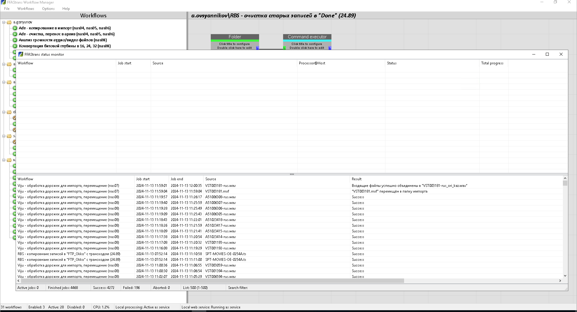

Unfortunately reorganizing modules/tasks didn't help. Running and finished workflows are not displayed again when some of the workflows are executed:
Снимок экрана 2024-11-11 171101.png (136.14 KiB) Viewed 112329 times
Снимок экрана 2024-11-11 171038.png (179.75 KiB) Viewed 112329 times
log:
webint.zip
(346.99 KiB) Downloaded 945 times
