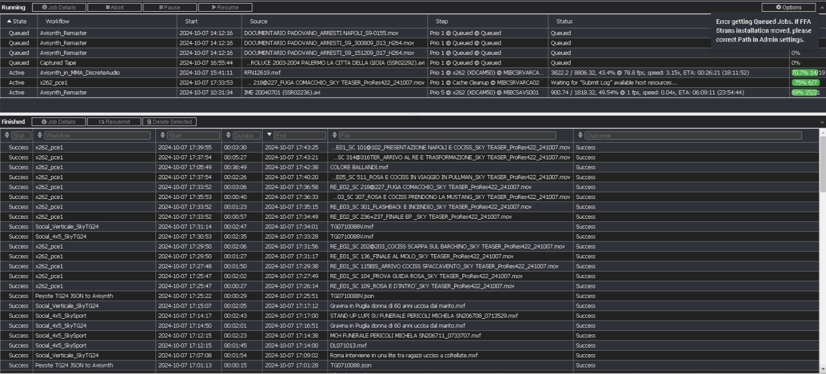

Stef wrote: Mon Oct 14, 2024 11:23 am Sometimes there's an error getting queued jobs ("Error getting queued jobs. If FFAStrans installation moved, please correct Path in Admin settings.)".
Yep, that's something I noticed as well and reported privately to emcodem a few days ago, but I'm really glad that you could reproduce it as well!
Screenshot from 2024-10-15 12-57-13.png (454.97 KiB) Viewed 89234 times
emcodem actually said that he's still working towards the migration from API to reading from file storage and that the issue we're seeing there is given by the APIs.
The very good news, however, is that we won't get that error for much longer.

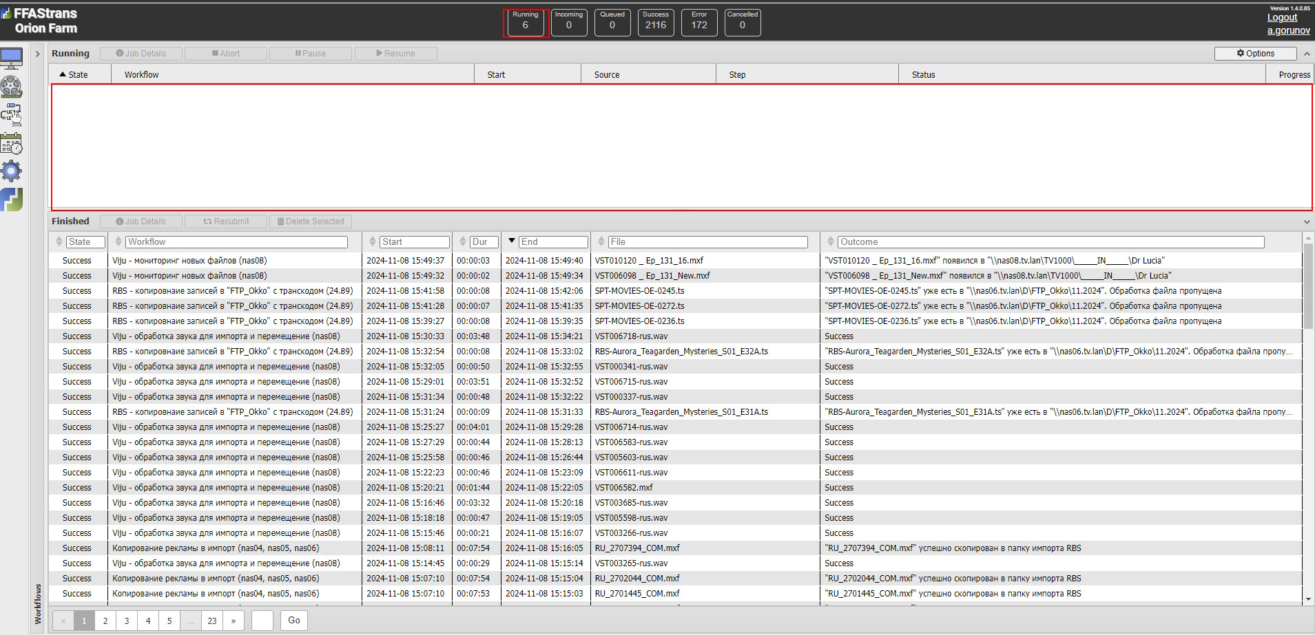

DCCentR
Posts: 39
Post by DCCentR »
Hi guys, thanks for wonderful this project!
Noticed the following problem - current tasks are not displayed on the web page:
But in status monitor all is ok:
It wasn't always like this, originally it was okay. But after a while, it started.

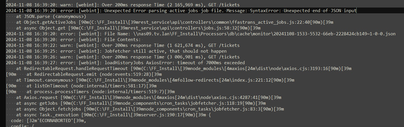

In log i see this errors:
It's fresh install of FFAStrans v1.4.0.7 & Webinterface v1.4.0.85. FF Install dir on SSD and webserver is on the same machine in same folder.
My logs:
logs.zip
(257.79 KiB) Downloaded 828 times
Can you tell what is the problem here?
UPD: oh and it seems finished jobs also stops updating on web
Hi @DCCentR
sorry for letting you run into this problem in first place and thanks for the report, perfect that you deliver the webint log along.
So my guess would be that you only see this behaviour when there are jobs running, taking away CPU and especially Bandwith to your NAS09 share.
It is of course important for me to support such problems but it is kind of hard to test, can you please confirm try raising the "API timeout" in webui->admin->Network settings from 7000 to e.g 120000? Meanwhile i'll reactivate some old Raspberry Pi and configure it as WLAN NAS so i have something slow for testing this kind of Situation.
What exactly happens:
So webint reads lots of files from the job history folder (history jobs can currently block active jobs update). When there is network activity, the Latency to the share raises, e.g. if you have 2000 jobs in the ffastrans history and usually each one takes 0.1ms, the response usually takes 200ms, so far so godd but as soon as you have network activity on the same netwok cable, the time for each file raises and we soon have 10ms per file or more, leading to a very long update time.
Of course i have already multiple strategies to try to cache stuff and avoid this but looks like some of it is not working as expected.
