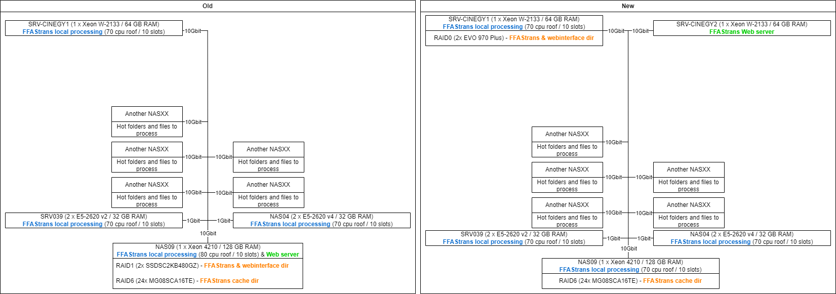

I tried reorganizing the tasks a bit by unloading NAS09 (the old scheme that caused the problem and the new one):
Диаграмма без названия.png (92.47 KiB) Viewed 112353 times
So far, the problem has not occurred again.

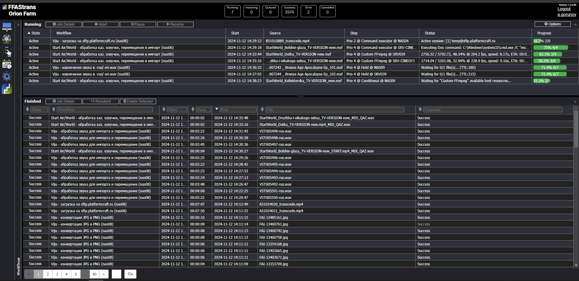

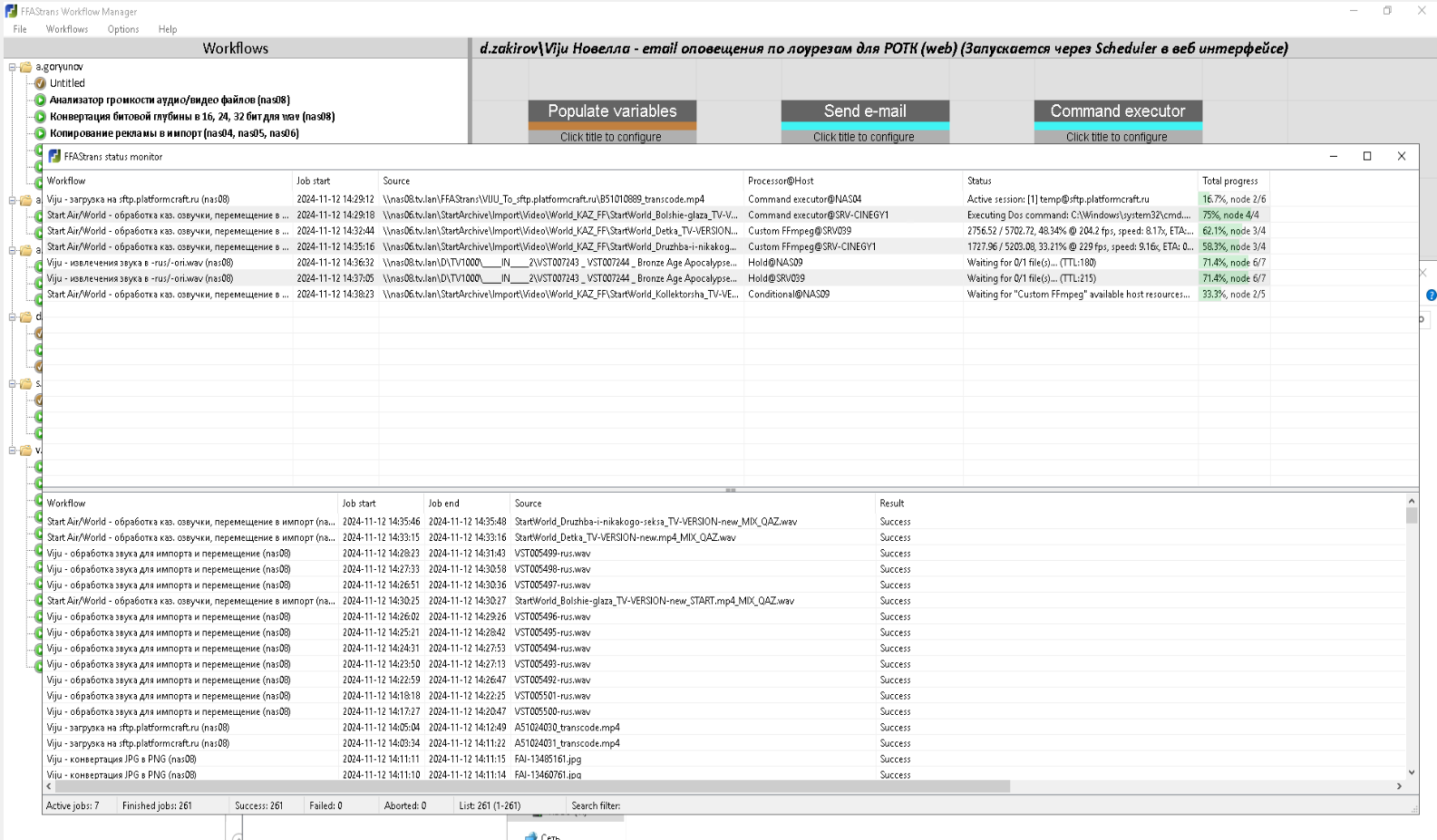

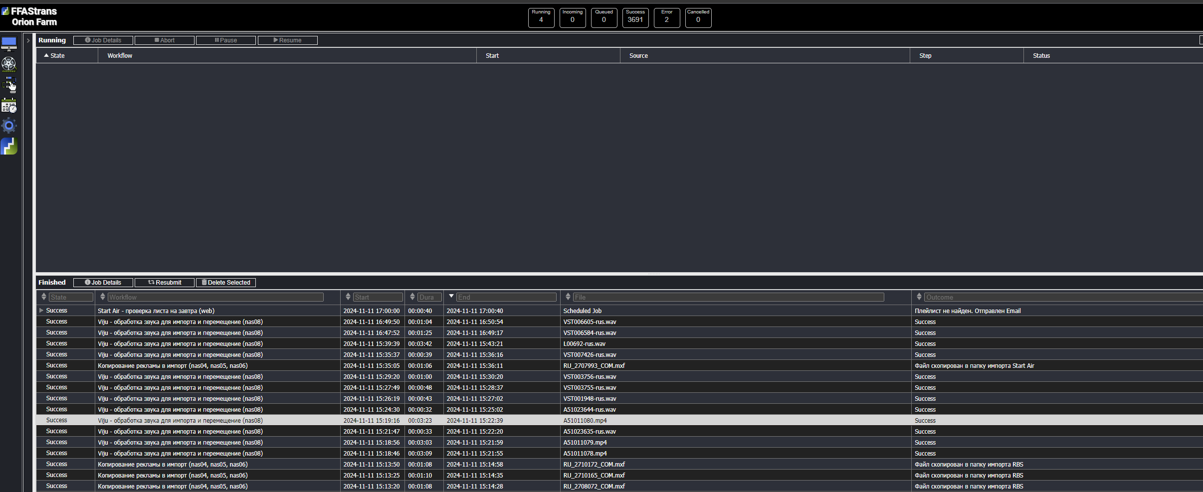

Unfortunately reorganizing modules/tasks didn't help. Running and finished workflows are not displayed again when some of the workflows are executed:
Снимок экрана 2024-11-11 171101.png (136.14 KiB) Viewed 112317 times
Снимок экрана 2024-11-11 171038.png (179.75 KiB) Viewed 112317 times
log:
webint.zip
(346.99 KiB) Downloaded 944 times

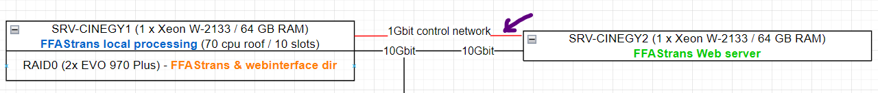

Regarding the separate management network, I can connect the servers with “FFAStrans & webinterface dir” and “FFAStrans Web server” with 1Gbit (or even 10Gbit if needed :) ):
Снимок экрана 2024-11-12 121735.png (24.38 KiB) Viewed 112288 times
Do you think a separate management network for these servers would be enough? (for solving web inerface issue)
@DCCentR
Well i in first place you definitely face software shortcomings, e.g. the caching can be optimized a lot, and it must be optimized. Not everyone can build a separate control network ;)
But yes i also think that 1Gbit control network is far enough, as long as you can keep the data transfers from the Control network NIC the latency to the files should be good. But i didnt test such a setup yet.

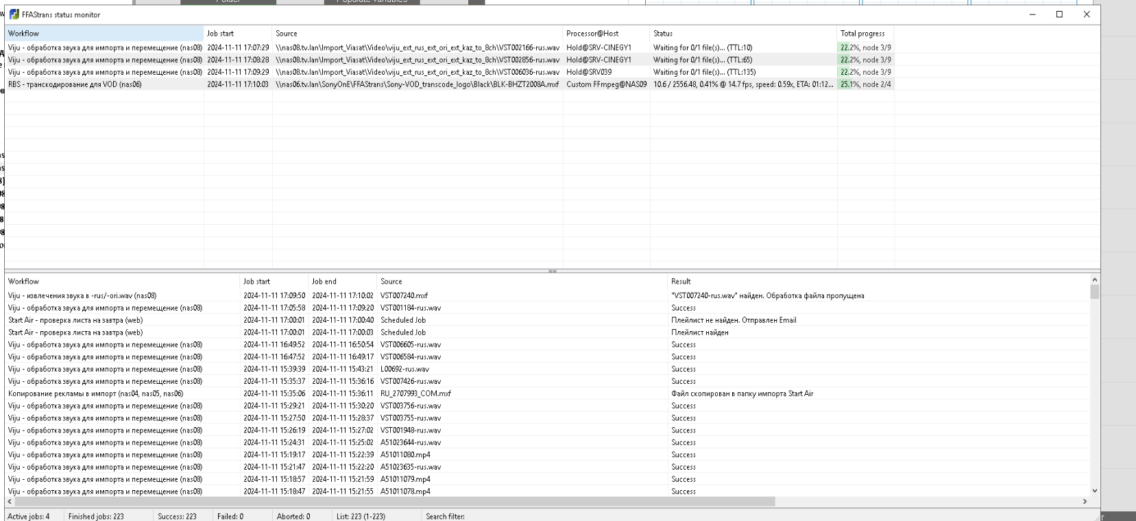

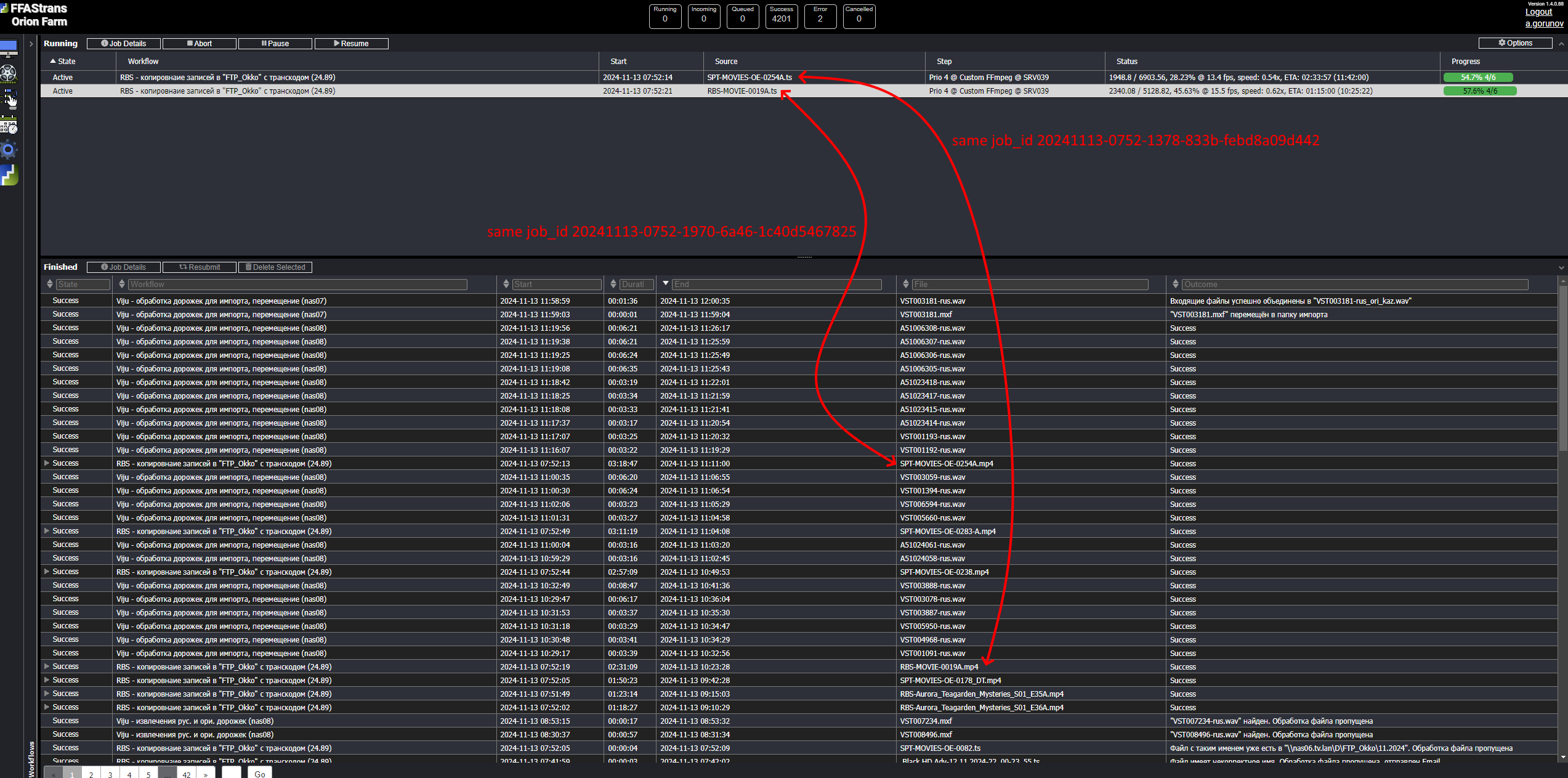

Another little report on v1.4.0.88.
Somehow this two jobs stuck in running, but they were done already:
Снимок экрана 2024-11-13 120354.png (295.61 KiB) Viewed 112219 times
Снимок экрана 2024-11-13 120439.png (96.33 KiB) Viewed 112219 times
logs.zip
(1.27 MiB) Downloaded 853 times
cache jobs 20241113-0752-1970-6a46-1c40d5467825.zip
(357.06 KiB) Downloaded 913 times
cache jobs 20241113-0752-1378-833b-febd8a09d442.zip
(528.02 KiB) Downloaded 791 times
Didnt't try restart webinetrface service yet.
@DCCentR Oha, i guess that is not performance related at all :D But most likely "cache" related
So i did not yet see this behaviour but it seems to be somehow related to jobs with "multiple tasks" and usually my jobs are just single task.
This time unfortunately the logs and cache folders are not really helpful but i'd like to know:
1) just refreshing the page does not "solve" the issue?
2) can you try the localhost:3003 api method GET /jobs and tell me the output?
The output of GET /jobs method will return 100 last history jobs and when you scroll to bottom you will also see "active" jobs, do you see the same 2 jobs there? If yes, can you also check processors/db/cache/monitor folder and see if there are json files for the jobs you see on webint?

emcodem wrote: Wed Nov 13, 2024 4:59 pm @DCCentR Oha, i guess that is not performance related at all :D But most likely "cache" related
1) Nope, refreshing didn't help
2) These two "active" jobs are in the output:
jobs.json
(25.31 KiB) Downloaded 999 times

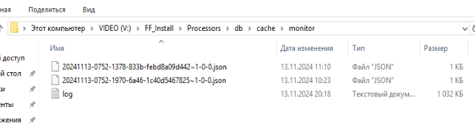

Yea, there is a two json files with matching id's:
Снимок экрана 2024-11-13 204403.png (39.22 KiB) Viewed 112184 times
They have something weird with security permissions, I can't see the owner etc. and they don't open for reading either (even under a domain administrator account) :?
A have running "FFAStrans REST-Service" & "FFAStrans Webinterface" services on every machine in farm under a domain administrator account.
Here's the log from there just in case:
monitor log.zip
(159.48 KiB) Downloaded 892 times
UPD: rebooting the server with FFAStrans dir solved the problem with security permissions on json's :D
