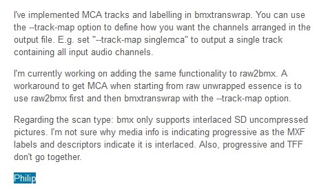

Hi Steipal,
I have checked with BMX team, they told me to use bmxtranswrap after raw2bmx process. I have added bmxtranswrap.exe to FFAStrans\Processors\mxf_tools folder. Please find below screen shot for your reference.
Please suggest how can use another command line to process.
Vijay
