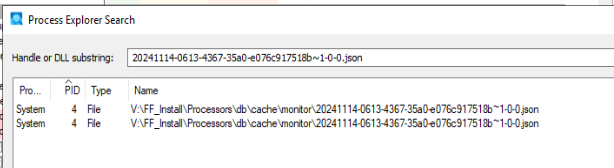

The next one didn't take long :) This time it was the jobs of the same workflow as before, but they was stuck in web and in status monitor too:
Снимок экрана 2024-11-14 110110.png (60.43 KiB) Viewed 113541 times

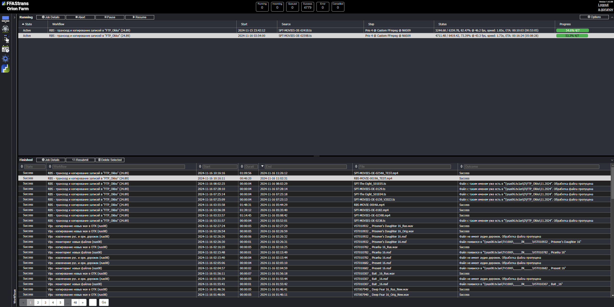

I found these files are locked only by host machine (SRV-CINEGY1) serving the FFAStrans dir and also doing local processing:
FFAStrans dir server3.png (37.77 KiB) Viewed 113541 times
Opened by Administrator for reading:

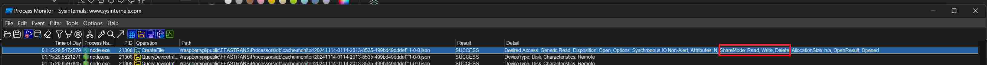

Also I managed to start Process Monitor on SRV-CINEGY1 something around 13 minutes before jobs get stuck. it seems that when cmd.exe appeared, the problem started:
FFAStrans dir server2.png (1.72 MiB) Viewed 113541 times
Here is the events list from Process Monitor filtered by one of the stuck json (20241114-0613-4367-35a0-e076c917518b~1-0-0.json): https://dropmefiles.com/LHJuA
And full events list without filter, containts all three jsons (20241114-0615-1434-9971-43cca26ef65f~1-0-0.json, 20241114-0613-4367-35a0-e076c917518b~1-0-0.json, 20241114-0616-4487-7178-ca416d100302~1-0-0.json): https://dropmefiles.com/wuW7z

The cmd.exe you noticed is not the problem but it wants to be a solution. It is started by ffastrans and it runs in an indefinite loop, trying to delete the file every 5 seconds in case the normal file deletion did not work. Steinar told me that this workaround is in ffastrans since a long time. But obviously the workaround does not work :D
What catches my interest in your PML and screenshot from locked files is that the path is "V:". To be exact, procmon shows that ffastrans (exe_manager.exe) does access the file sometimes using path "V:" and sometimes using the full path.
To be more exact, within the same millisecond, we see for example exe_manager.exe ReadFile access to these 2 paths:
\\192.168.24.231\FF_Install\Processors\db\cache\jobs\20241114-0613-4367-35a0-e076c917518b\log\20241114T082655692_9892_9f00e2_sys_SRV-CINEGY1.json
V:\FF_Install\Processors\db\cache\jobs\20241114-0613-4367-35a0-e076c917518b\log\20241114T082655692_9892_9f00e2_sys_SRV-CINEGY1.json
I first thought V: is a mapped network drive but according to my tests, access via mapped network drive letters is still logged in procmon with the full UNC path, at least in my installation.
Do you know what V: is and why every process seems to access both, the full UNC path and V:?

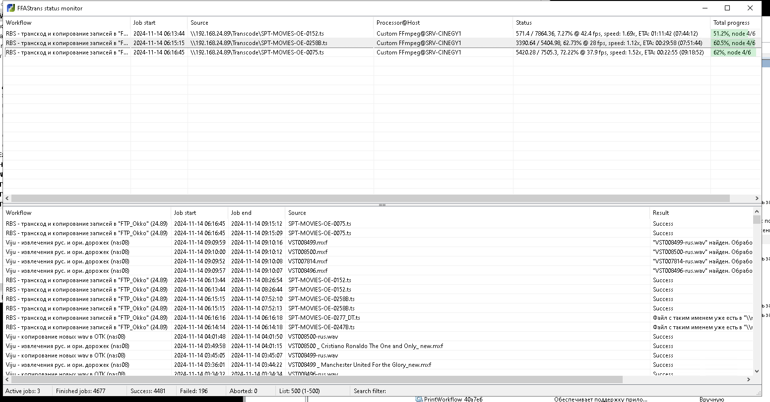

And it's a fairly common task, it processes files every day:
Снимок экрана 2024-11-15 212545.png (355.44 KiB) Viewed 113457 times
I set aside a couple of source files where the hangs were occurring. I'll try to reprocess them a few times.

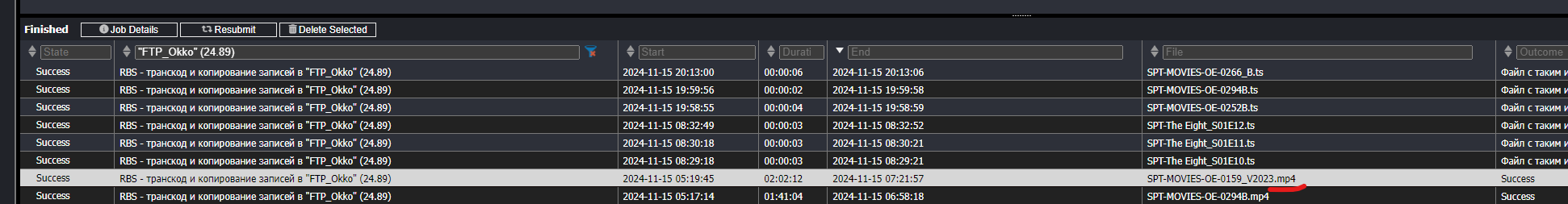

Since we mentioned this worflow, here's something else I noticed - for some reason the column for the file in web does not contain its original extension:
It's not related to hangs and probably only cosmetic but still ;)

Today I found two more stuck tasks of the same workflow:
Снимок экрана 2024-11-16 163500.png (224.5 KiB) Viewed 113396 times
