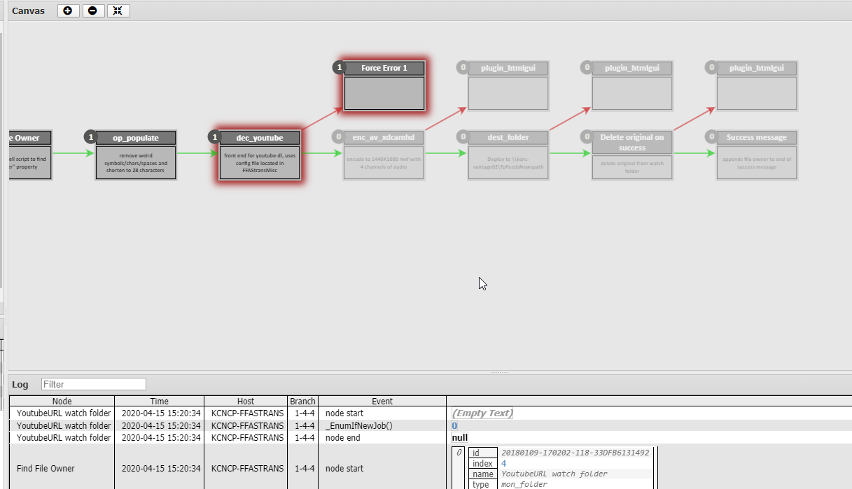

One last thing. The Force Error block, if the processor name is left unchanged in the workflow manager, shows up as plugin_htmlgui in the advanced WebUi (sreenshot). If it is modified, the modified name does show up correctly. The name is *not* affected in the result field of the basic webui or the outcome field of the advanced webui.
2020-04-15 15_21_31-FFAStrans Workflow.png (59.26 KiB) Viewed 24787 times

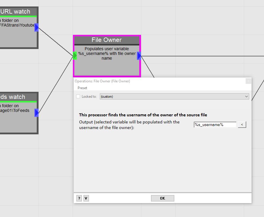

Attached is my first, meager, attempt at a custom processor. I took the "Force Error" example that @emcodem helpfully wrote and blatantly plagarized it to make my own. This processor is called "Find Owner" and grabs the source file input to the processor and finds the owner of that file using powershell Get-Acl and bit of regex to strip it from the preceding domain. In production I made a user variable %s_username% that I append the message "submitted by %s_username%" to the success or failure messages of later processors so I can see who is submitting files that are causing errors. I have also used it as the input to an email processor that automatically emails %s_username%@mycompany.com on failure of their job.
I originally accomplished this function using the built in "Command Executor" to run the script, but there were issues with certain long file names that contained emojis and other symbols that were causing issues. This required multiple "Command Executor" and some pass/fail branches, so I made this instead. It works, so far :D, and makes for a cleaner less complex workflow and I learned a few things.
Please note I am not a programmer, this is 99% copy paste other people's work with a lot of trial and error thrown in. If you're interested in re-writing this one or making your own .... read on.
Somethings I found helpful when building this. Right click workflow you are working on and select properties>maintenance tab>check the "keep jobs until completion" box, otherwise FFAStrans will delete all of the files of interest after every job. Go back to the General tab and note the path in the Work Folder window. Submit some test jobs to your workflow with your custom processor and then go to the workfolder path you found earlier (it will probably look something like c:\.ffastrans_work_root\20200417-2214-1523-1732-8c822b35uda). Once in that folder you can see all the files that are created as a file goes through (or fails) in your workflow. I found that the file ending in ~plugin_htmlgui~stdout.txt contained the windows command run by my processor. I could copy paste that and run it directly and see what errors where happening in the console window.
The files ending with ~plugin_htmlgui.inputs.json and ~plugin_htmlgui.outputs.json contained all the JSON input and output key value pairs. I toyed with using the json sources.current_file value but using the $1 argument directly was easier. Hopefully some smarter person will correct me if that is the wrong assumption.
